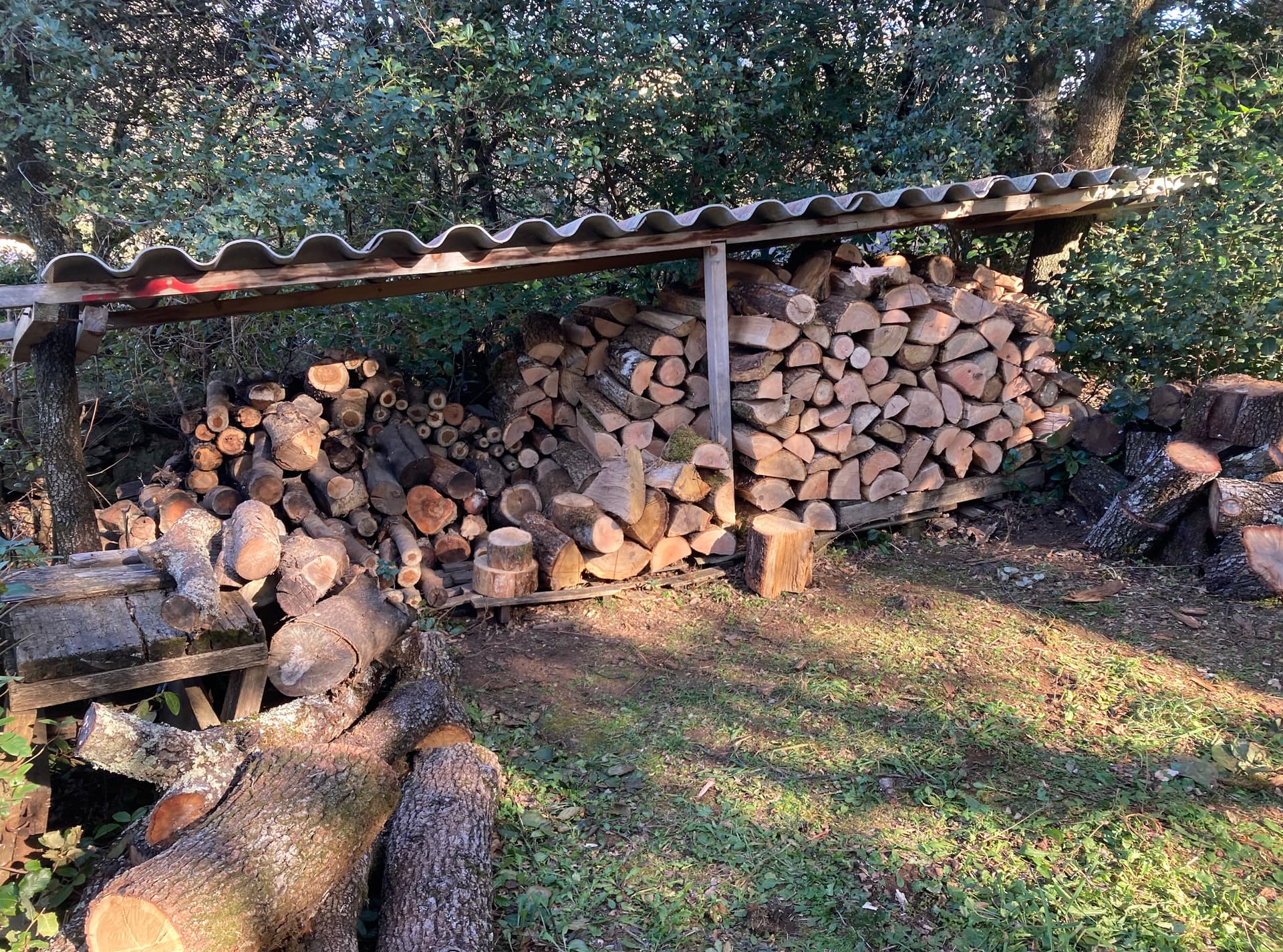

Just sorting out the wood for next winter …all from my land .

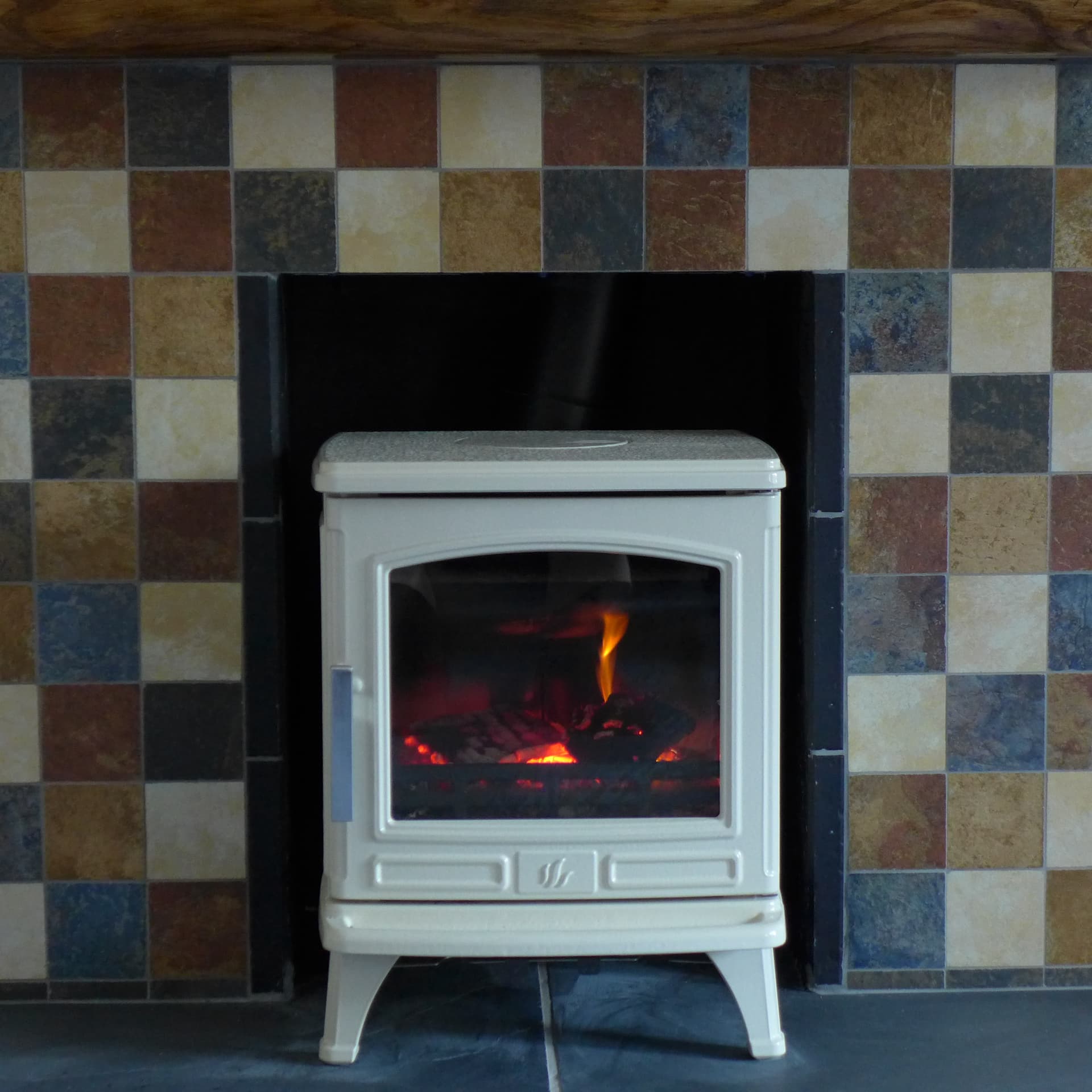

After months of waiting for the work an to turn up, he finally did last week - fixed the chimney / flue on our clearview last week. The metal chimney had dropped an inch or so and needed the sealing gunk sorting out. Hence it was not possible to turn it down at all…. Now we have a lovely clear view as the burn is much cleaner and more controllable and the glass is kept clear. Hasn’t been like that for months

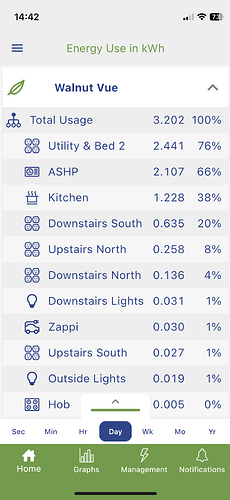

When the electrician moved all my circuits bar the HiFi radials to new CUs with RCBOs and surge protection, I got him to add the Emporia Energy Monitor which came with 16 CT clamps for circuits and 3 for the Distribution Boards.
I can monitor everything now! Before I had a method of estimating the ASHP consumption just using the main outlets which had a mix of SmartThings and Meross energy monitors. These are quite useful for using ToU (Time of Use) tariffs. Octopus Agile is making a comeback now and apart from peak times offers savings. It a matter of managing the domestic use, which might be difficult with a young family. Our dishwasher could be started and then turned off, to be turned on by an automation at the off peak period. I also have an IFTTT applet that checks the Agile rates and can switch an outlet on when a criterion is met. I don’t use Agile though!

That looks very useful. I’ve been mostly managing with socket adapters which monitor live/historical usage for plugged in items - handy for figuring out what has and hasn’t been utilising much energy.
