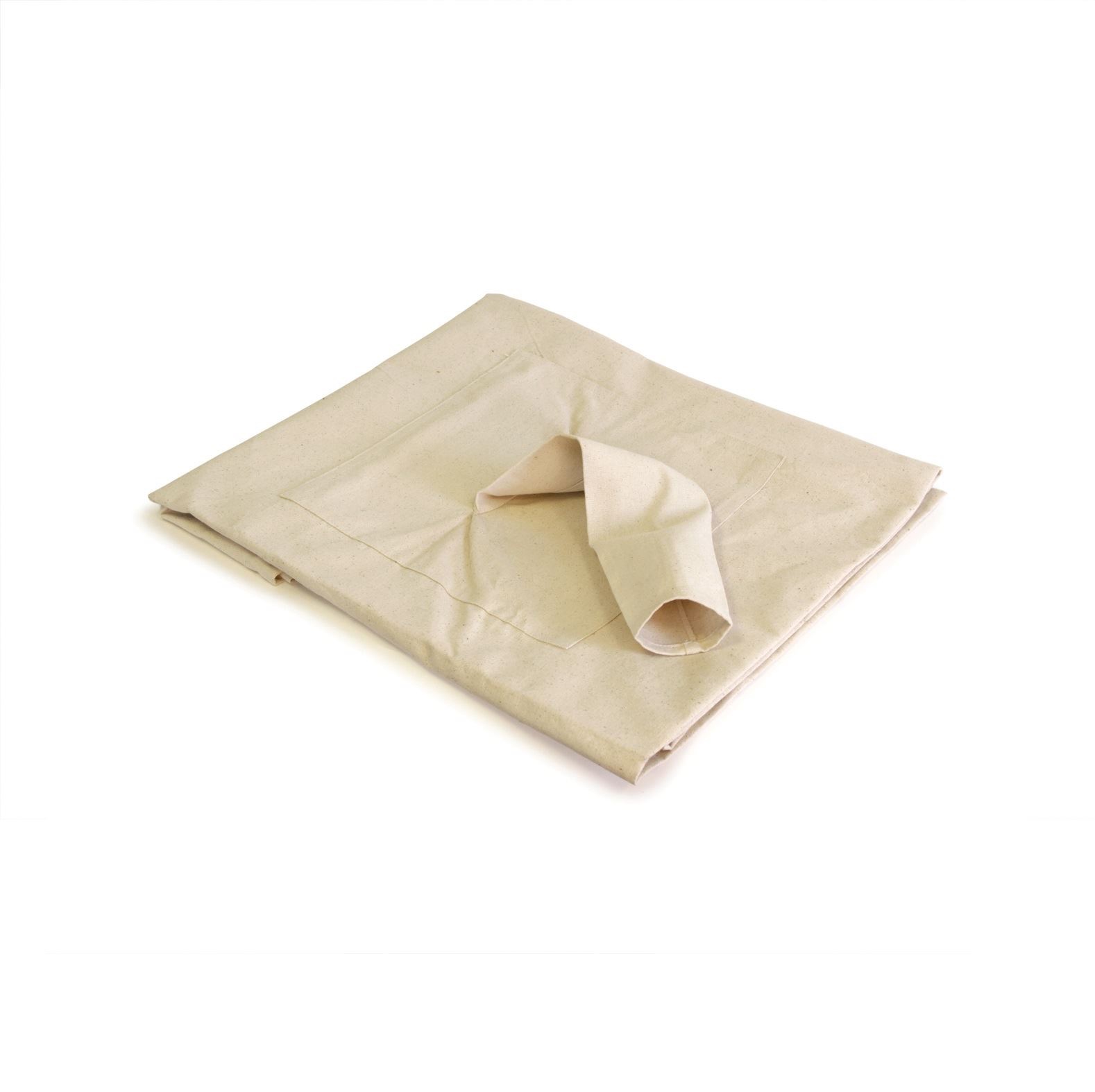

A couple of things that may also come in useful:
The dust sheet is obvious, the tube thing above is a “FlueBoss Powersweeping rod guide is ideal for protecting rods from sharp edges inside an appliance whilst spinning. Also fitted with a 38mm T piece which can be connected to a vacuum.”
Wish i’d purchased one at the time (for the free postage) it’s a need if the stove has an acute angle to get the rods up the flue, i found the rods and push-fit connectors get a bit scuffed on the edges of the T junction flue fitting. Will have one for next time.
A few years ago i threw out an old Henry Hoover trunk, a small section of that would have been ideal for free.
You may not need one if your stoves have easy access with a straight path up the flue.

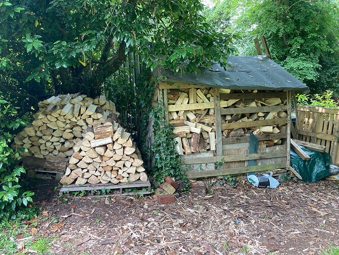

I try to hold off until the end of September, I find once you start it’s difficult to stop! I have got this lot and half as much again to get through but I’m running two Clearviews this year and no oil boiler!

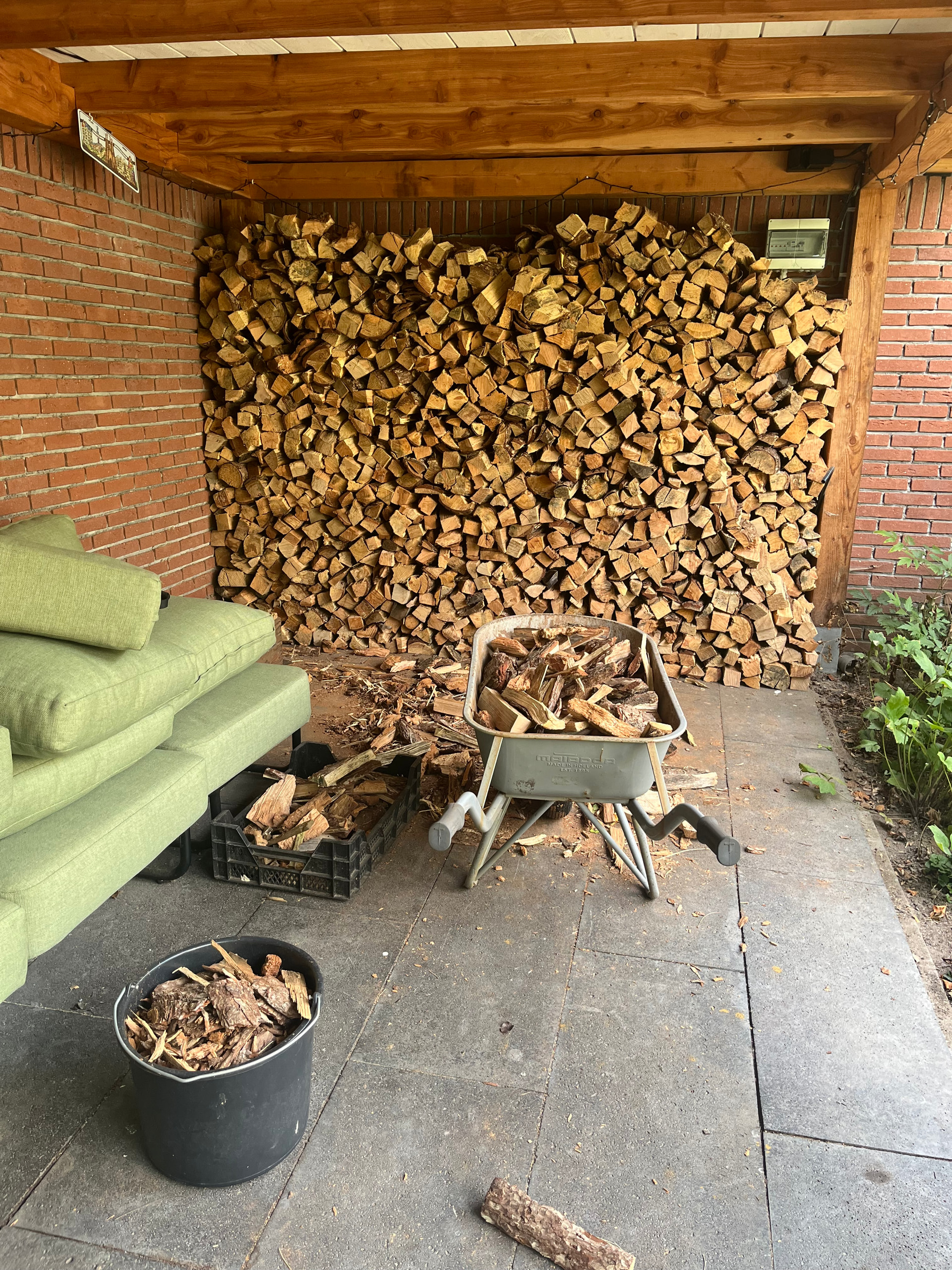

Here’s my stack.
It was a lot of work but the nice thing is that there’s always a kid interested in helping which is a nice touch.
Or as a colleague at work told me when I showed her a similar picture “another home for spiders”. Nice store though!
