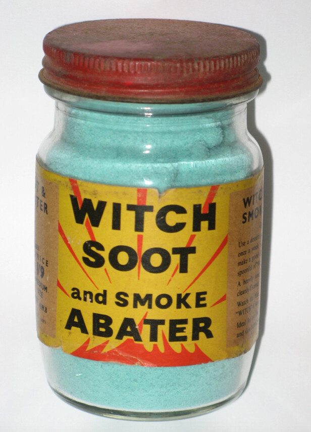

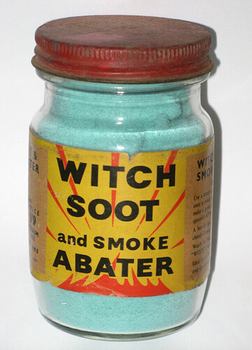

I seem to remember back in the late 50s or early 60s when I was living at home with my parents, that they used to put some sort of powder onto the burning coal of an open fire to “clean” the chimney. I believe it was quite a common thing to do at the time. Cannot remember the name of it but “Witch” something rings a bell.
Rock salt, possibly?
That’s it, they turn the sticky tar into a brittle powdery deposit that either falls off, or is easily brushed off. If the flue is very dirty it sometimes results in chunks falling off and building up in the grate.
I would certainly hope not! A steel lined flue wouldn’t last long.
Think most chimneys were brick lined back then.
This?
I think so but it was a long time ago
Whats in it?
Found this on Google
https://homeguides.sfgate.com/flue-chimney-cleaning-chemicals-47263.html
From the colour I’d imagine some copper sulphate amongst other things!
I’ve seen various comments on the newer ones perhaps containing magnesium and phosphate compounds.
Nice and environmentally friendly then!
‘Every little helps’ as Tesco would say (or is it another supermarket) :neutral_face:
