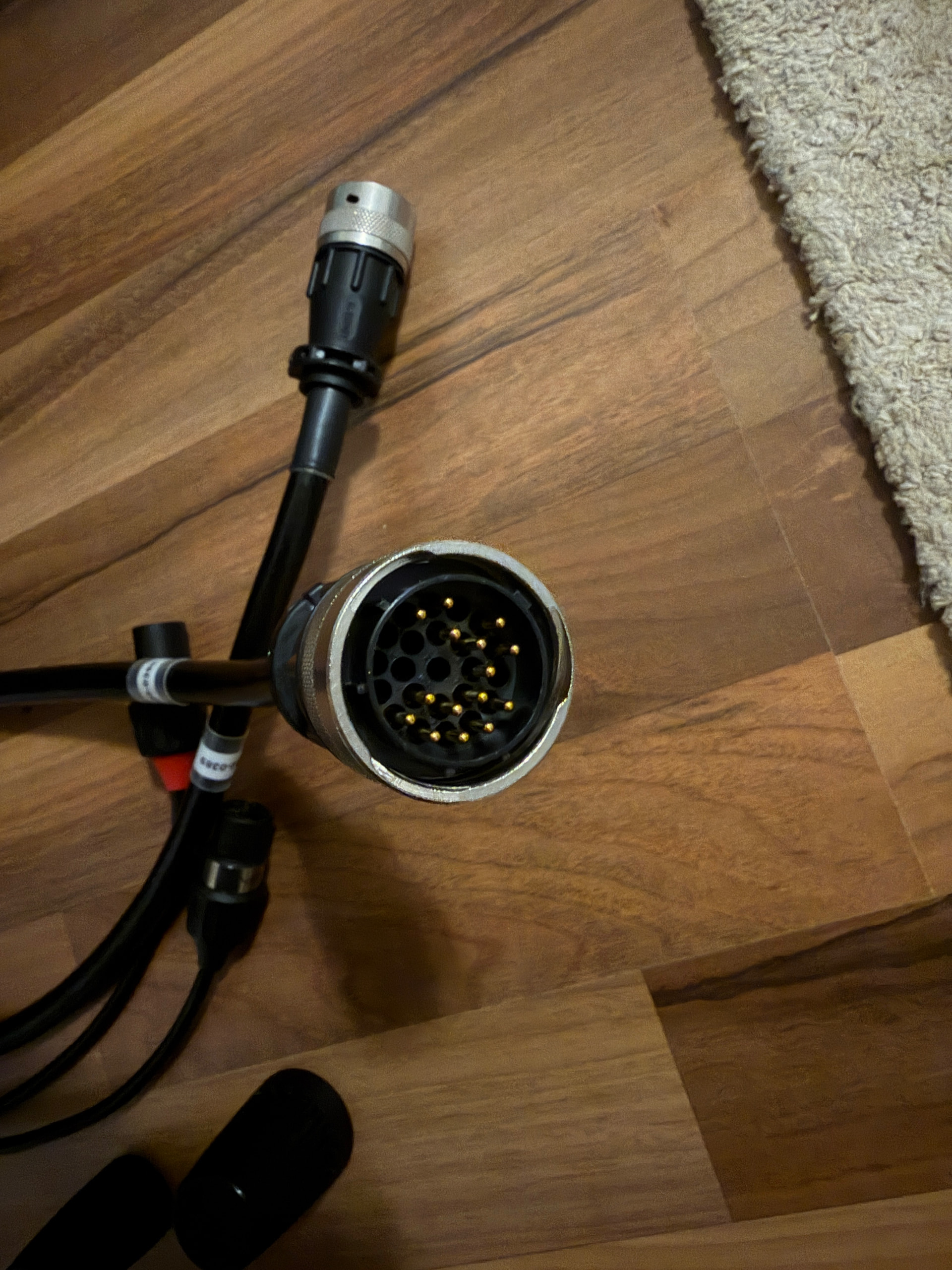

  • Is the burndy locking ring fully tightened?

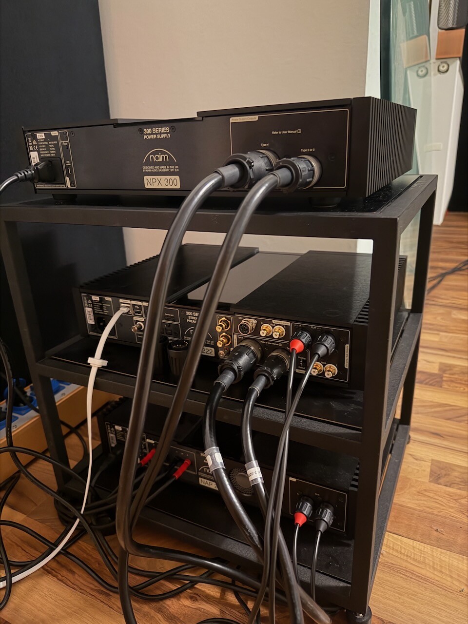

  • Can you share a clear photo of the back showing both the connections on the 300 and 222?
For nearly all Naim kit behaving weird with an external power supply it is either a loose connection or a missed secondary connection (for units that require it) or a blanking plug in the wrong place.
And to add, have you removed the power lead from the 222?
Have you connected both Burndy leads correctly? If you have, and disconnected the mains from the 222, it’s likely that your 300 or its burndies are faulty. If it’s new, your dealer is your first port of call.

Still worth posting a picture, just in case.
This doesn’t suggest that it’s connected properly….
Everything is connected correctly.
Lights are possible to set to LOW but not OFF so seems like something is wrong then.

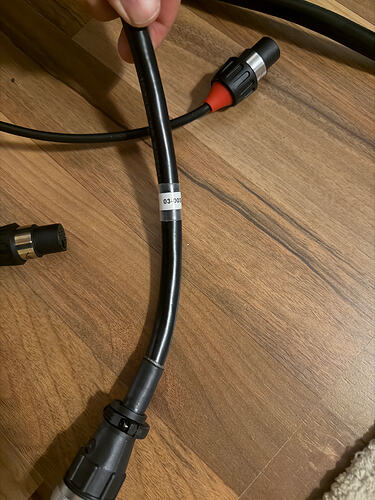

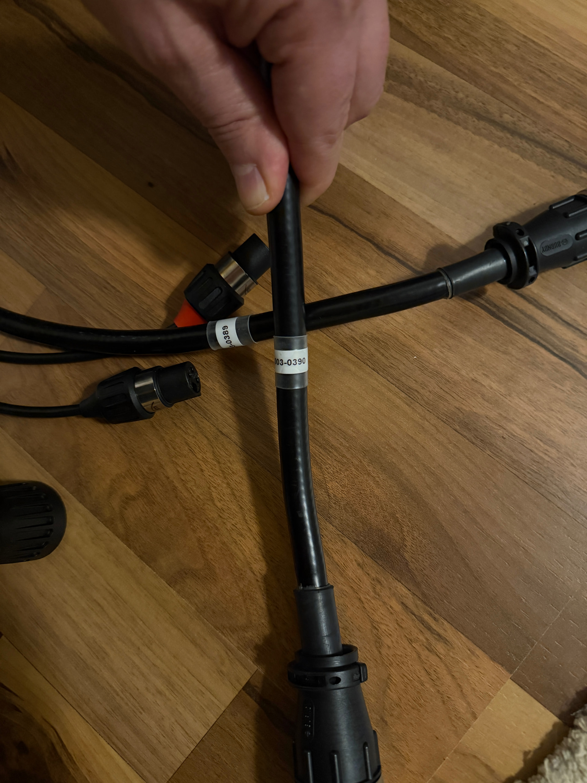

Not sure if it’s possible to mix up burndys but you are sure you use the right ones?

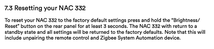

All NC kit has a logo light brightness reset button on the back, so it should just be a question of using that to get it to come on.

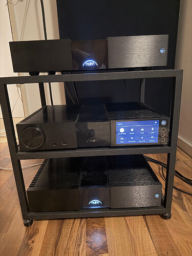

I see that you have your NPX300 Power supply on the top of your rack, perhaps without it, that was the empty shelf? Nevertheless, putting the PS above the preamp in the 222 may not be a good idea. Can I suggest, even though it’s a big job, that you rebuild the system in the usual configuration with preamp at the top? It may just help your connection issue, but if it doesn’t then get your dealer to provide help in the form of new cables, or a new unit.

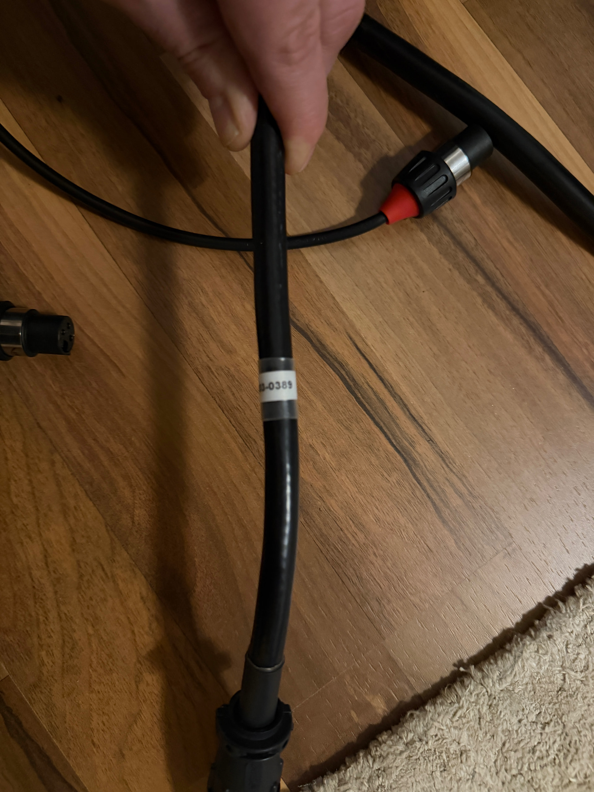

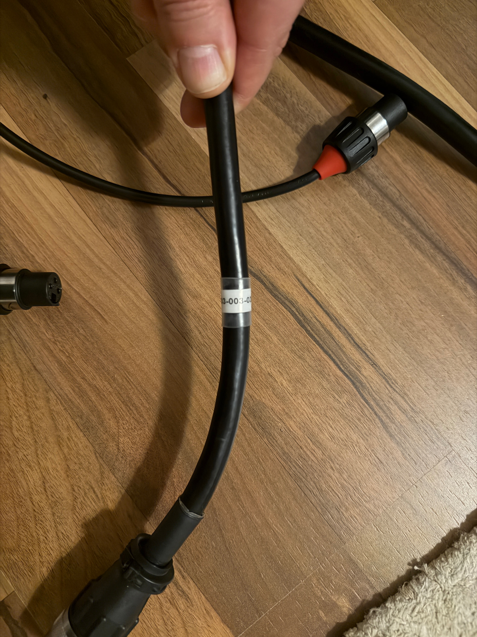

Here are photos of the two cables.

Have you made the reset?
The burndys on New classic can be very tight sometimes. You shall hear/feel a distinct click when it’s all the way in.
The 222 doesn’t have a button. I’ve already done that via software.
Apologies, you are correct - I assumed that like my NAC332 preamp, it would, for use whether it was connected to a separate power supply or not.

PS Naim replaced the Burndies supplied with my NPX300, originals simply too tight to fully lock.
If problems with too tight Burndys I recommend this one and to remove the rubber strap, wrap it around the metal part on the Burndy and gently turn by hand (not using the handle). It makes it sooo much easier.
Although having to use additional force on £6k products does seem somewhat excessive, verging on the unacceptable……
Much better to get Naim to replace them with a set that just works correctly - ie using finger force only.
