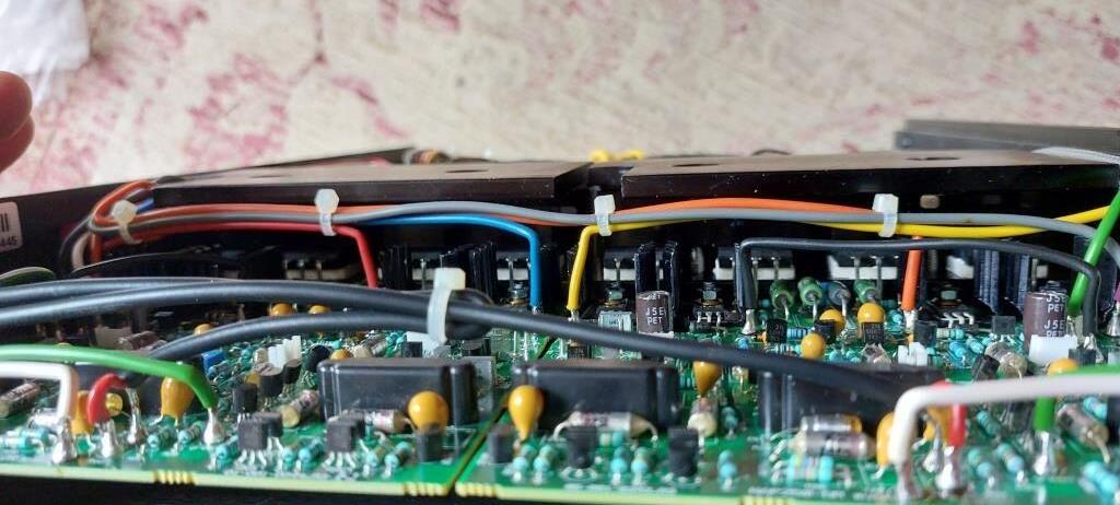

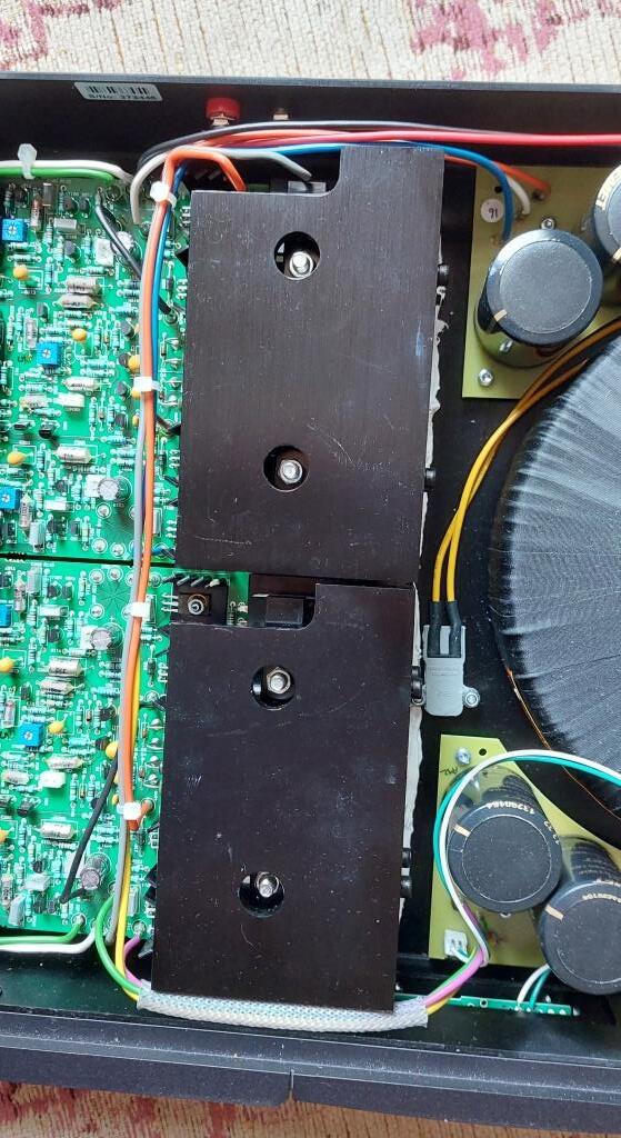

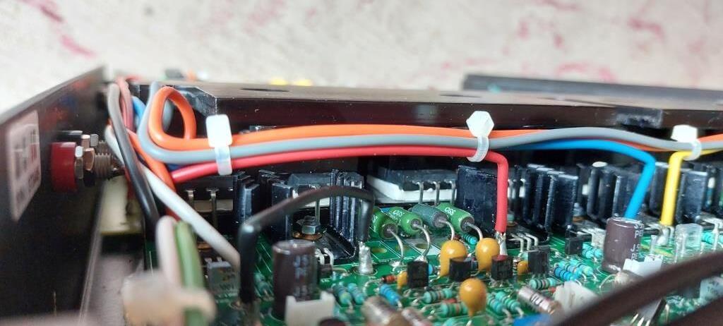

250-2 and 250DR visual differences?
Curioser and curioser.
What have I got here?
I appear to have the heatsink with the recesses but still the 250-2 shape?
Paging @Richard.Dane for comment… :thinking:
Yes it would be nice if anyone from Naim or Richard recognises this configuration. Comparing the pictures the underside of the heat sink appears to have the 009’s.
All connected up and is working well. I am going to have to get used to the sound and then swap back to the 250-2 to compare. It seems to be have a little more bass at low levels but that could just be me and buyer expectation.
I wonder if it’s a NAP250.2 upgraded to DR spec? Or maybe a transitional model? I’m no expert here on the later classic kit so probably best for @NeilS to comment.
Thanks Richard. It was sold as a 2016 250-2 upgraded to 250DR in 2018. Unfortunately Naim say they have no record of that. I do have a copy of the dealer invoice to the person I bought it from but no serial number is recorded on that invoice. I will contact the dealer at some stage but before doing so I wanted to have an idea of what I have- DR or not.

Interesting you confirm it’s an upgraded unit, I guess perhaps the original heatsinks are drilled and reused? Again, I’m sure @NeilS can enlighten on the process.
The entire PCB/heatsink assemblies were replaced during a DR upgrade.
@bruss your heatsinks are the correct DR ones, I’m unfamiliar with the ā€œfullā€ versions in the pictures above, perhaps those pics were of a pre-production unit.
If I’ve picked out the serial number correctly, your unit was updated @ Naim in Aug 2019 & the power switch was replaced at the same time.

If I have read the Serial No right (starting 37xxxx - ?), it shows that it was a 2014 build.
Thanks Neil. That is really helpful. Unfortunately the service department had missed this when I enquired recently. A big relief. I owe you my thanks and a drink if our paths ever cross.

Brilliant, thanks for clarifying @NeilS I guess the ones shown in the official pictures were the pre-production ones?

That’s all I can imagine, I haven’t seen that style of heatsink in the flesh. Seems odd that the cutout would be omitted, as it was present in the non DR version. Obviously the cutout provides clearance for the Ch.2 speaker sockets/wires.
