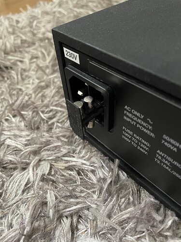

300DR just died. How to change fuse?
My 300DR just shut itself off. I opened the fuse box where 2 spare fuses are located but where’s the fuse to be changed? I pull out the full fuse assembly or I need to open the box?

Both the below measures OK.
You don’t need to open up the case. The two fuses shown - the one nearest the case is the fuse in use (and maybe blown). The other is the spare. Just swap in the spare.
Are you sure the fuse is blown and the switch just didn’t latch properly though ?
You take the first fuse to come out and that is the broken one, then you put the second fuse to come out in the place the first one was and push the holder all the way in again. The contacts are just inside the fuse holder plastic, so you don’t need to open the box. In fact opening the box will achieve nothing at all!

They both measure OK with summer on the multi meter. Hmm.
It’s a good idea to ask your dealer for a couple of spares. Just in case it blows again in future.
Is there a fuse in the plug? Check that. Also try latching the power switch again as James said.

If the power cable has worked loose, this can cause issues and blow the fuse i.e. make sure it’s fully seated and not under stress.
