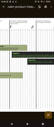

I’m hoping my newly aquired and early example of, a Superline will sound good out of aux2 of my 282 fed by 2 HicapDRs. Any ideas when Superline was released ?
The new product histories on the website are quite nice to look through
Looks like 2008?
Think mine is a 2008.
