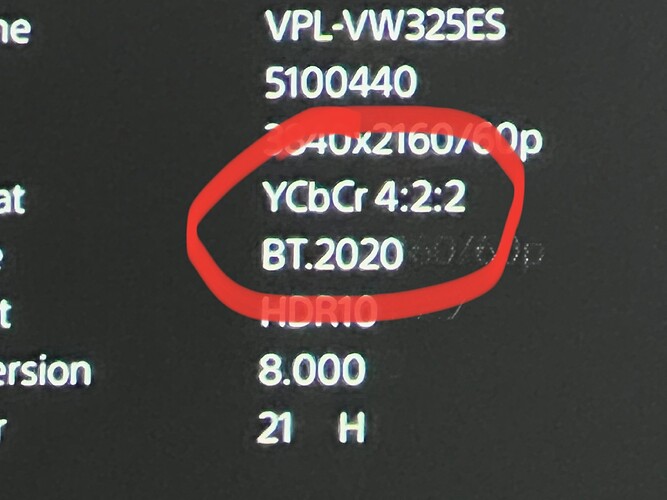

Hifi is my passion and my home theater is more of a hobby. I’m typically years behind the current specs and there’s always a few surprises whenever I make an upgrade. Latest update to my home theater is a Sony 325ES 4K projector. 4K has been on my radar for years, but the cost of entry was always more than I was willing to spend. I got lucky and picked up a 325ES as a demo close out for less than half retail. The salesperson mentioned I’d need “high speed” HDMI cables, but I was not clear on what this meant? I use Chord C-Stream HDMI cables and they say high speed on the jacket so I figured I was good. Well there’s high speed and then there’s 48gps. I quickly learned that in order to take full advantage of 4k, HRD and 4:2:2 color space I’d need to upgrade my cables. Thankfully these are easy to come by on Amazon at a very reasonable cost. Using my 4K Apple TV the images are simply stunning. Shows like Amazon’s Lord of the Rings: The Rings of Power or HBO’s House of Dragon look incredible. I was not expecting a sound upgrade. For whatever reason upgrading to 4K enabled Dolby Atmos sound. My system is 5.1, but very quickly I could tell the audio quality was superior, more detail and better separation between the front and rear speakers. Who knew?

And that cable would be…?
Ideally you want to be using an HDMI 2.1 compatible cable or higher to support the bandwidths (48gbps or higher). Lesser cables might work but you will need to drop the colour space compression up or reduce refresh rates….
I’m using a 48Gbps Certified Ultra High Speed HDMI cable. This is the only way to get 4:2:2 color out of the Apple TV4K.
Yep… that is what you need
Compared to the HD feed from my Apple TV, the audio quality did improve when I switched to 4K and starting getting Dolby Atmos. There must be some technical improvement?
Not one of the services deliver in 4:2:2 they are all encoded as 4:2:0 as is Blu-ray. 422 is only of use for computer gaming currently which can output at the higher chroma sampling. You don’t gain anything for TV at the moment not likely for some time. The advanced output on TVS and setups is only to get the higher frame rates which HDR services need as they all generally output at 60hz and that only comes with HDMI 2.1 spec.
Switching my Apple TV from 4:2:0 to 4:2:2 made a substantial difference in the picture quality. I’m a professional Cinematographer so I have an eye for these things.
AFAIK, 18Gbp cables support 4k@60p with 12bit 4:2:2 colour.
I’m a professional film editor so do I and I have seen no benefit of it. You can’t add what’s not there to start with. Same as I can’t make an aac or mp3 sound better by making it pcm. What’s gone has gone, upsamping isn’t going to bring them back. UI elements will be improved content is what it is.
But….That said all tvs have to upsample back to 4:4:4. before the final conversion to RGB to display the image. Native 4:2:0 was only possible via hdmi with hdmi 2.0 so all devices prior to this had to upscale to 4:2:2 for the TV then to upsample to 4:4:4 and then RGB to display them prior to this. Now all TVs pretty much support 4:2:0 and can perform this task without increasing bandwidth needed for HDMI.
So in your case it might be that you may like visually the artefacts of going through two upsampling processes from 4:2:0 to 4:2:2 via ATV then 4:2:2 to 4:4:4 then to RGB by your TV. I guess like some seem to think upsampling to their DAC makes it sound better than letting the internals of the DAC do it. Can’t say either makes a difference for me.
Yep you don’t need 48gbs cables unless your upsampling to 4:4:4 HDR on the playback device or needing higher than 60fps at 4k and HDR. So unless you use a games consoles or gaming pc it’s just not needed.
The problem with certified 48gbs cables is that they’re not certified at all. Cost doesn’t seem to be a guarantee either.
I see multiple differences in quality, starting with skin tones looking more realistic, far less chroma noise in highlights, and the overall image was smoother, less “etched” looking than the 4:2:0 output from the Apple TV. Whatever is going on the new HDMI cables allowing the 4:2:2 output made a difference I appreciate.

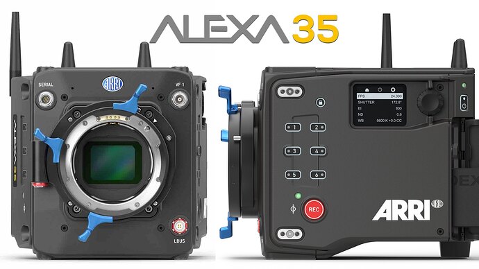

The new ARRI Alexa 35 will be the camera of choice for TV and film production for many years to come. Arri made advancements in both color and dynamic range that put it at the top of the digital cinema range. I’m friends with the product manager and its been fun to see his new “baby” finally come to market (3 years late due to covid). I do like my Mini LF as it provides a unique look with it’s full frame sensor. It’s been fun to use something new as I’ve been shooting super 35 for decades.
Here’s the new camera for Forum Members to see.
