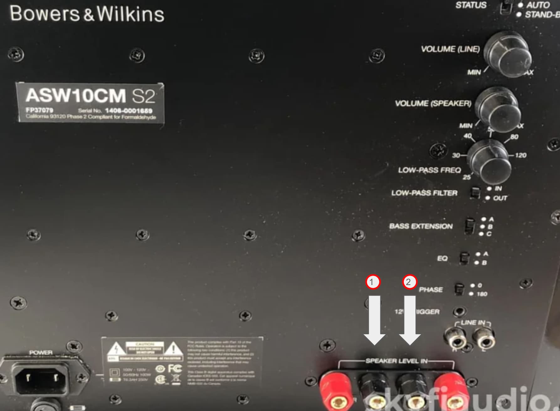

Is it me or is the high level connection right there in the photograph? Bottom right. "Speaker Level In"Also, I’m not familiar with the Cinemaquest but it isn’t on their current list of subwoofer cables.

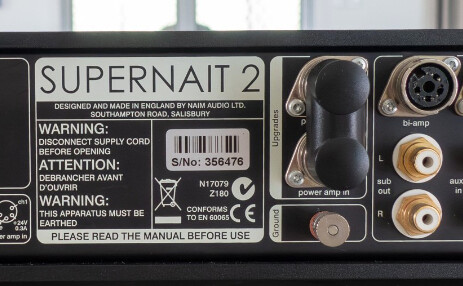

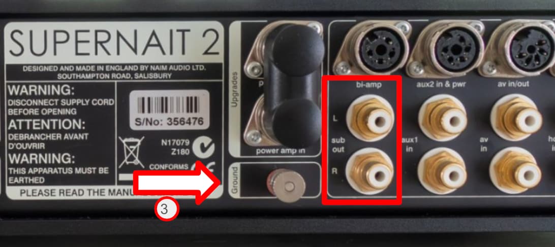

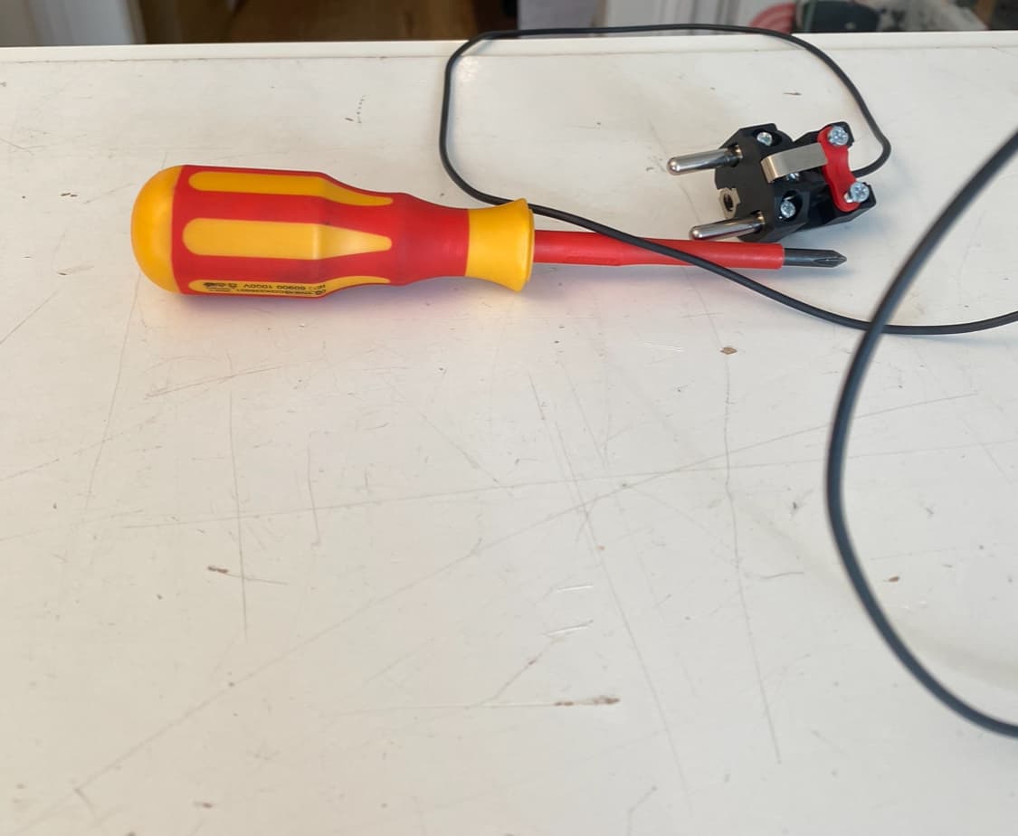

Thank you very much for the suggestions. I have since resolved the 50Hz ground hum. As shown in the following images, I made a DIY grounding cable with my local dealer which I connected to the power strip.
The first test, grounding the subwoofer directly (see 1 & 2), unfortunately did not lead to a positive result; instead, it introduced another, even deeper hum.
After further research, I came across the Audioquest Irish Red cable, which, as a pure subwoofer cable, has grounding at the amp end. Since the Supernait 2 has a grounding connection, I thought: if I use the line level at the amp, it will result in the B&W being grounded back through the Naim. Therefore, after connecting the DIY grounding cable to (3): tada. Silence. Problem solved.
As a troubleshooting step that is great. As a aolution, I’d be wary. The ground on the Naim is the signal ground, not intended as a mains ground.
Grounding the common on the high level inputs wouldn’t necessarily help unless they shared a common reference with line in ground, which apparently they didn’t. Given the home brew nature I’m half expecting Richard to moderate those pics.
It does make me wonder if the mains that the Naim is connected to is properly grounded for safety in the first place. If it is, you may have got rid of hum but introduced other noise you haven’t noticed yet. I’d think the long term solution would be a dedicated sub cable and connecting that cable’s ground to your device (incidentally, what you made is also for sale at considerable cost from companies like Chord and Atlas).
Naim send their signal ground out to input grounds expecting a Naim source to act as the signal ground for the whole system. The result of your test suggests you don’t have a Naim CD player or streamer (which would provide the ground for everything connected to the Nait).
Well done. But… I am with @feeling_zen in thinking this is a problem understanding step - not necessarily a long term remedy.
And - again as @feeling_zen suggests, perhaps the earthing of your Naim unit(s) is not of the best…? Please - do check… :thinking:
