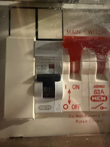

Could be this;
Can you confirm exactly what is tripping - MCB, RCD or RCBO?
Maybe a picture of the consumer unit?

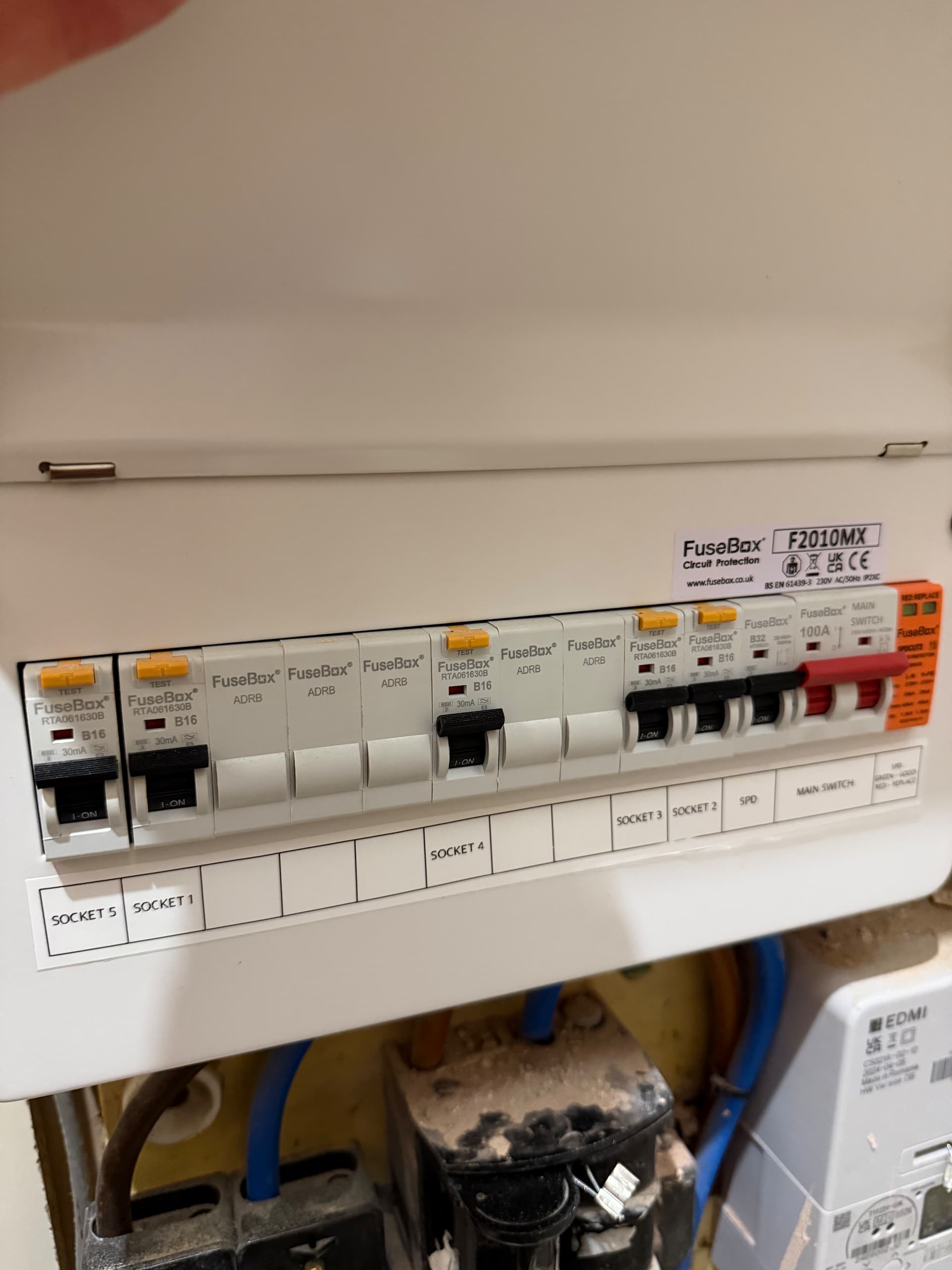

This is the board. My spark says type C are normally for commercial installations but is happy to help and find a solution
Indeed - my response was more for the benefit of others.

Fusebox fuse box envy :heart_eyes:
If the radials are wired in 2.5mm or larger, changing to 20A would be an option too.

They are 10mm
I had this with my 300, my sparky changed my trip to a C, job done!
Oh wow! You have a few options then.
