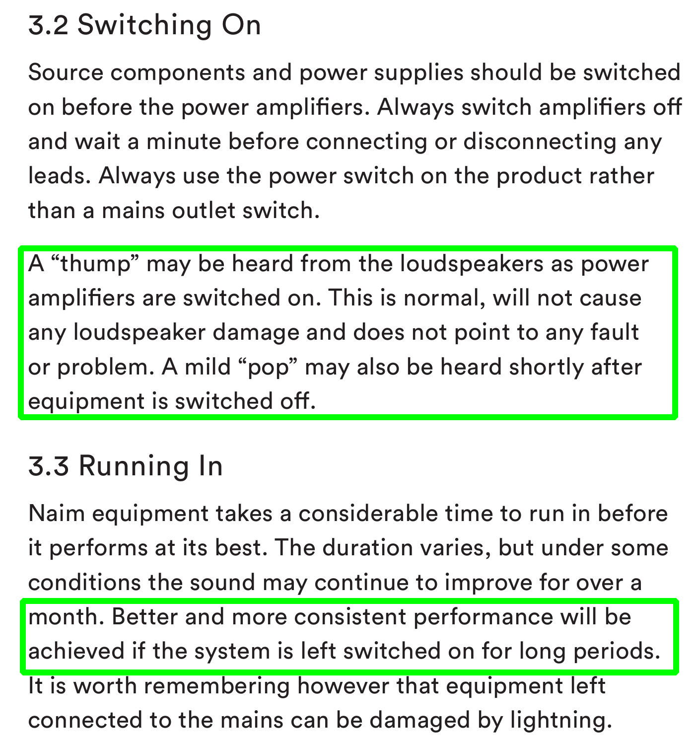

Hm. Nowhere in my manual does Naim recommend leaving this or any other amplifier on 24-7.
If I’m missing this somehow please refer to the pertinent section.
The sound is a pronounced sharp pop on power-up, and a much softer one power-off.
All with volume turned off, muted…
I guess I could unplug the speakers at power up then select a source? A less than graceful workaround agreed.
I’ll add it’s not a problem I’ve had to deal with on my venerable Cyrus 1 from 1986.
Meanwhile I’ve reached out to Naim themselves for a solution. I’m not sufficiently reassured that this issue won’t harm the superb speakers I’m using, Monitor Audio SE 25th Anniversary minitowers, last of the UK- built MAs.
Less than helpful.
Where does Naim recommend the amp or anything else be left on 24-7?
Not to be found in my copy of the manual.
Please show me in the manual where it is recommended that this or any other piece of Naim is to be left on 24-7.

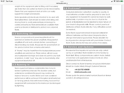

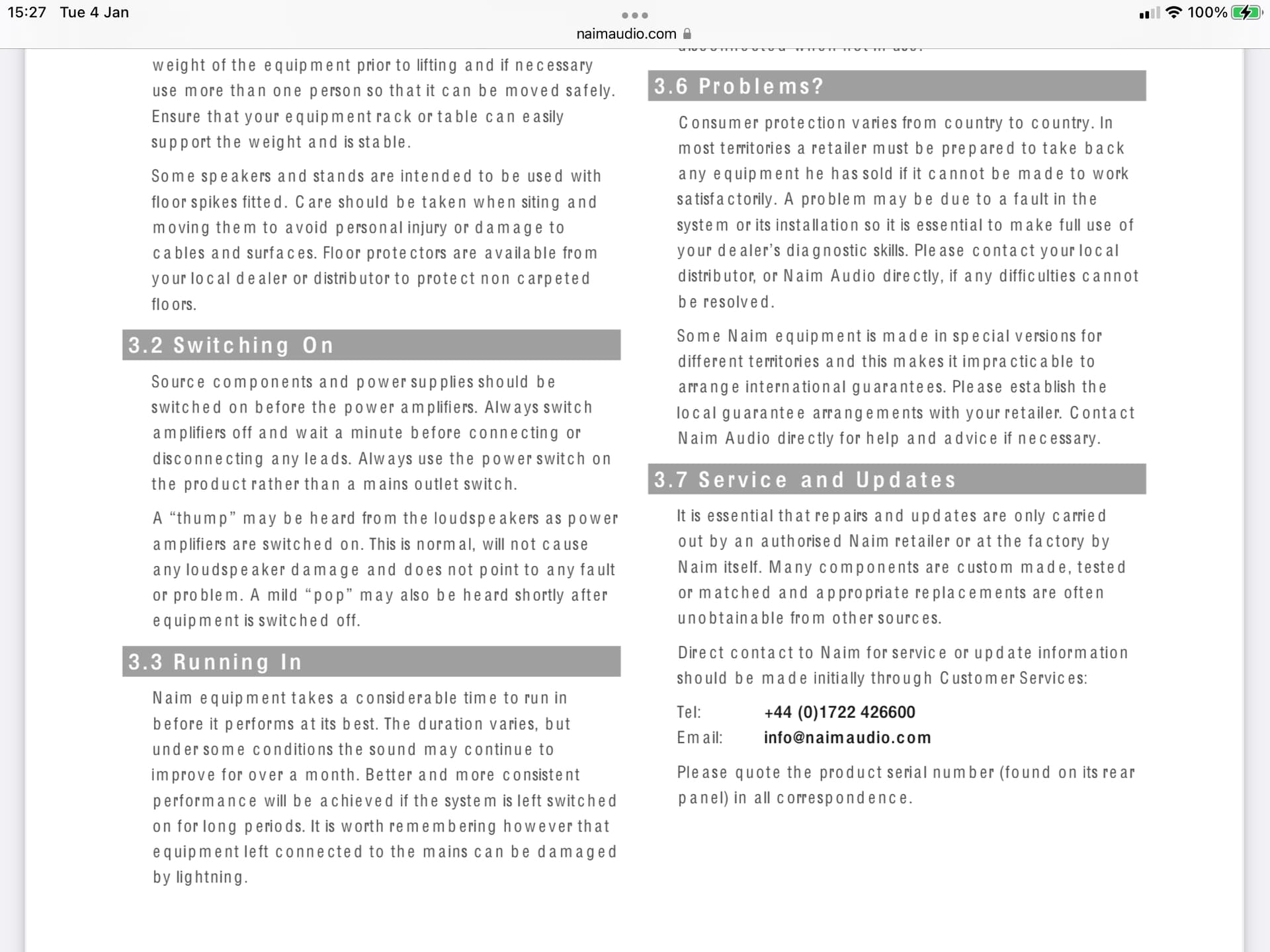

Section 3-3 describes leaving on and 3-2 relates to your power-on thump. I think this manual includes your amp, mine are so old that they’re not in here, so I’m not certain about this being the right one.
https://www.naimaudio.com/sites/default/files/products/downloads/files/amplifiers_reference-manual_english_issue5.pdf
Can’t find the Nait 5i manual online, but this is from the 5si and all amps have the same in the manual:
Granted that it dos not say 24/7, but it does say “long periods” and the fact that the 5i model have the on/off switch at the back is a hint ![]()
As I said above it is not an absolute requirement, feel free to turn it off every time, not a problem either.
If your pop is not exceedingly loud, it is not a problem. As stated, it is possible to avoid it by adding a relay to the output, put Naim decided otherwise.
I do agree that dealers should point this out. If a person feels that the popping is more important than the music, Naim is not for them. That’s fine too.
I think the fact that the term “long periods” is preceded by “the sound may continue to improve for over a month” is pretty much advice to leave it on at all times if possible. Mine only gets switched off for holidays and thunderstorms.
Personally I’d follow the written advice in the manual over some local tech guy.
The advice to keep it on came from my Naim dealer 22 years ago, and my kit has been on and working ever since. It also seems to be the advice from other Naim dealers, so by all means check with who you got your from.
