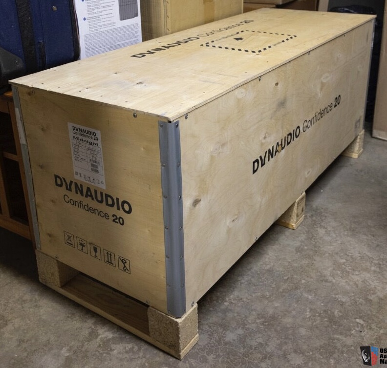

They do in fact come with the correct stands. Both speakers and their stands come in a massive wooden crate.

Seeing that picture brought back memories of moving house whilst serving. They (boxes were called MFO boxes) were used to store personal belongings in transit between quarters (military accommodation). They were also used extensively to move items (equipment, paperwork etc) between units as part of larger logistical moves. Not the easiest to assemble/disassemble.
Absolutely that. With every previous house I’ve bought the music room was a critical criterion - in some cases the prime criterion - and it would have been in this case except the house came up at a low price for quick sale, requiring a decision and commitment in just 3 days. We were there at just the right moment to view, and it ticked so many boxes - extremely rare in the chosen location - that i had to look at it differently, considering music room potential rather than actual. Fortunately I am good at visualising and could see a couple of options, so we went ahead - snap decision from “perhaps we need to start looking at houses sometime soon” to 2 days later organising money and legal things, then rapidly doing what was necessary to get our existing house ready to put on the market, then working feverishly to tie up all the other things we needed to do before moving to a different country… From first weeing this house a year ago to now it has been hectic, and I’m looking forward (still) to having time to do all the things I planned to do when I retired five years ago! The last house was supposed to be our forever home - this one now has the same status!
That’s really cool! Just need to find a place to store that box! I bet the box and packaging would be very expensive to replace!
