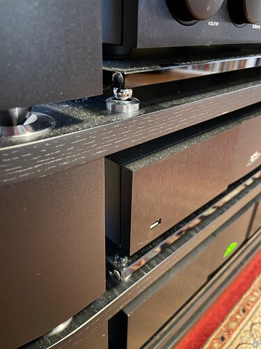

You could experiment (upgrade) what you have by just buying the bearing shoes, ball bearings and getting some glass (to Naim spec). I suspect many dealers have spares.
Check the shelf specs but as all Fraim risers are common across FL and full-fat Fraim (FFF), then your FL shelves should accommodate these items.
I’d start with sources and pre first-up if it was me.
Of course, you won’t have the recess on FFF shelves for the bearing shoes to sit in but…not such a loss. Perhaps a tiny amount of Blu-Tac to hold the shoes in place?
I recently upgraded from fraimlite to fraim for my pre and streamer. I was quite surprised the difference some glass made! More detail and more enjoyable. I’m sure you wouldn’t be disappointed. Given the suspension systems in some of your 500 kit with their solid feet (no rubber), I would think they would love some glass to sit on?

The Fraim is much much better than the Lite. It’s not just about the glass and the cups and balls; Fraim had a decoupled base, a different shape to the shelves, and posts to stop the glass shooting off the back. I’d say it’s a case of do it properly or don’t do it at all.

The maximum number of Fraim or FraimLite levels (excluding the base level) is six when standard length uprights are used and two when extended uprights are used. Do not exceed these limits.
Although it would be very difficult to demo a full set of Fraim versus Fraim lite with your active system your dealer might be able to set up a simple passive system demo for you to compare, maybe a Pre Amp > PS > 500 > PS > Speakers.
If you go for the full Fraim I would recommend using the clear plastic glass locator things as they stop your glass shelves moving and possibly chipping the glass or damaging the veneer on the shelf.

I don’t use those those glass locator’s because I think they are more fussy then worth, but I do affix little 3M rubber bumpers to the front edge of the glass, to prevent chipping if they get pushed into the metal stanchions. I learned that the hard way when my 80 lb Rottie would hip-check the shelves. She’s gone now and my other Rottie keeps his distance. I don’t even notice they’re there, but it’s an effective measure.
It’s mostly if it slides off then the glass will fall onto the metal cup and that’s what normally does the damage.
