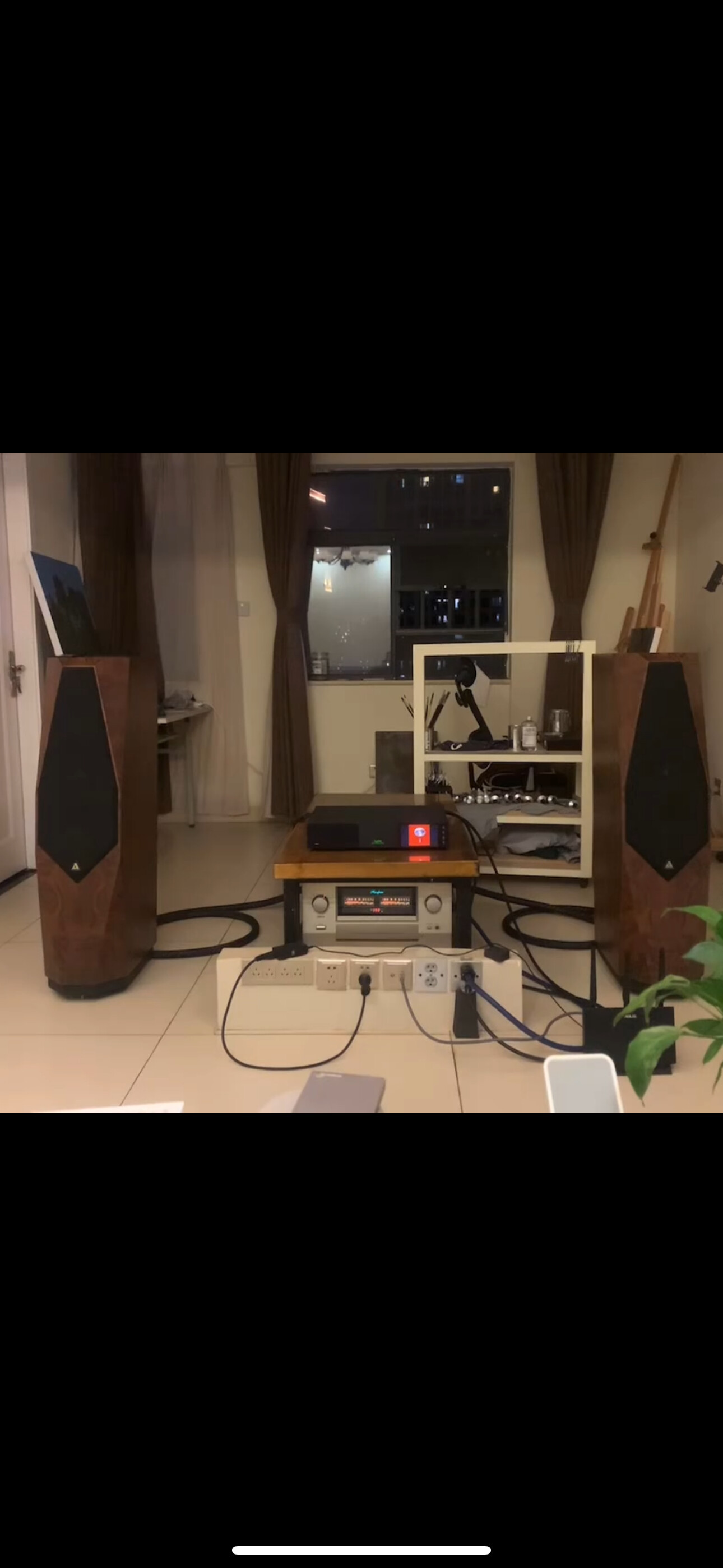

My friend owns an E800 paired with Avalon speakers, and the streamer is an NDX2. He’s an audiophile who likes trying different speakers, amps and cables, but this combination has stayed with him for a relatively long time and remains his setup today. He once sold his NDX2 after trying options like the Esoteric N-05XD, Auralic and Aurender and more…. but eventually returned to the NDX2.
