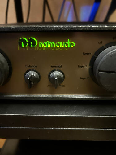

Friends, the knob (normal, mute, mon) works well in normal and mute but on mon it gives me the same result as the mute. Shouldn’t he, instead, let me listen to mono?

Is mon for mono or for monitor?
Monitor
I don’t know!
Monitor
That is what I thought
Most likely you’re right, it’s about the conando monitor.
Monitor, useful when you are listening to a 3 head cassette deck or reel to reel so you can “monitor” the recording as it’s recording.
Oddly enough, the NAC72 dropped the very useful Mono function of its predecessor, the NAC32.5. I find I use the mono button fairly regularly - useful not only for mono records, but also for setting up recorders properly.
The mono function would be really comfortable.
Yes I know
The way to have a “NAC72” with a mono switch is to find a NAC32.5 and fit the NA329/729 time aligned boards.
