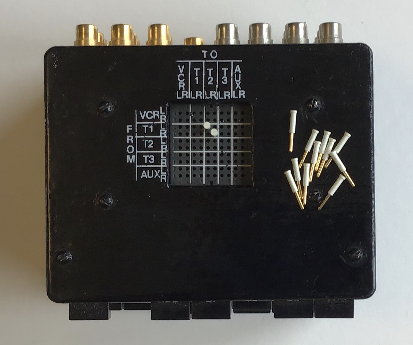

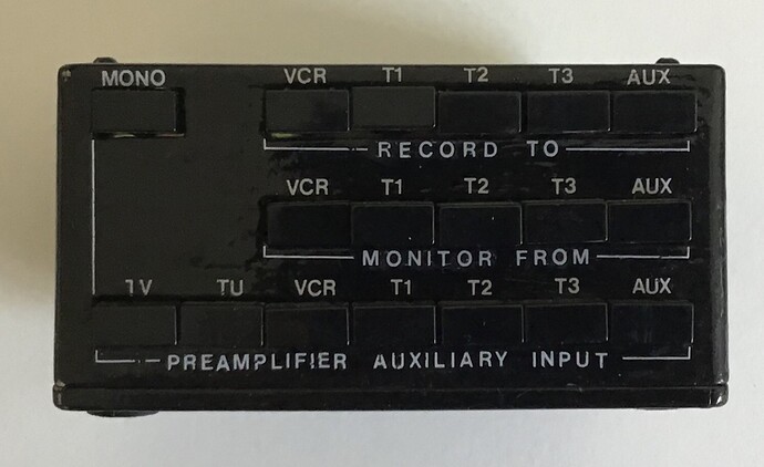

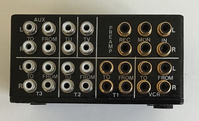

Some years ago (alright maybe 30!) when I was dabbling with recording and creating sounds, and at the time having a pair of reel-to-reel tape recorders (Sony TC377) amongst other things, I made my own switch box.
The box connected to the tape record and monitor sockets of my preamp, and also to the Aux input (the preamp only had Phono, CD and Aux inputs). Pushbutton switches allowed selection of any of the connected sources (choosing from 2 tape decks, cassette, VCR, Tuner, TV and a spare) to the Aux preamp input, and independently any of the recording machines to the tape out and tape monitor sockets of the preamp.
It also included a matrix board with insertable pins that could connect any of the box’s input sockets to any output socket - intended for easy setup of odd connections, e.g. for bouncing left to right channels.

The idea for the matrix board came from some time previously messing around with a VCS3 synthesiser - the matrix so much better than Moog’s telephone exchange style cable patching. I kept the box simply because I never know if one day I may want to have more connection options than an amp may have - and maybe also because things like that are both unique and full of loving care!
