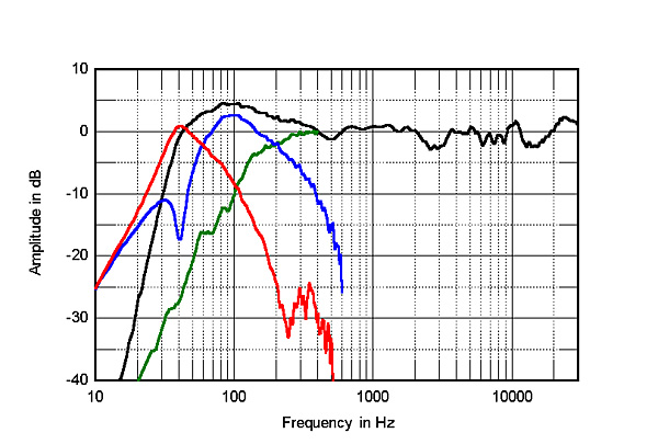

That’s not really true. The lowest note of a piano is around 27hz, which is about 10hz lower than the specified bottom frequency of the Kanta 2. Now that is quite lot, considering that full range speakers lose a lot of power in the lower registers (below 100hz), which you can also see in the frequency response of for instance the Kanta 2:
A decent sub will have no trouble compensating that loss of power up to the crossover frequency:
I said “barely”, not “none”. And it will not be unrepresented, 25 Hz are still there with -20 dB. Which is a lot of dropoff, but our brain reconstructs it from the harmonics as well, which is why standmount speakers do not all suck big time in a completely unusable way.
A 4-string bass in standard tuning on the other hand has a 41 Hz minimum, which the Kanta 2 does with minimal dropoff. Given how much piano music I personally listen to, and how often (not) the lowest key is used in it, I for one can live with this.
And while a sub helps with that, you create yet another crossover frequency, phase issues, etc. I am not saying that subs are useless, but it takes a lot of care, and my recommendation would STILL be to first rethink the apparently poorly thought-out plans and then to see if there are real problems to solve

Sure but because of the rolloff in full range speakers you will have to play them very loud in order to feel them. With a subwoofer that isn’t needed, the power is always there, also in softly playing music.

Yes there is always room for improvement, 10-15hz is already really difficult for most subs to reach…
Cannot agree, I feel bass at normal and lowish volume. Sure not as much surely, but you make it sound as if it was like wearing headphones. Maybe not having a Nova helps, I do believe that this very much improved with my system compared to the previous one with same speakers, so as the OP does not even have the Nova yet, I STILL recommend they should first rethink and/or try what they really want
Well i didn’t intend to imply that… But with 20-30db attenuation at those low frequencies, it will be 3-4 times softer/quieter than the rest of the music. So you would generally need a bit higher playback volume to get a decent amount of air moving…
