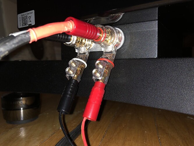

when you said high level connection from speaker terminals, are you referring to using these connectors ? Thanks.
Yes, they are the high level connections. You take a signal from both speakers.
Is there a specific name for this type of connector? I am trying to do a search and find where I could get these connectors.

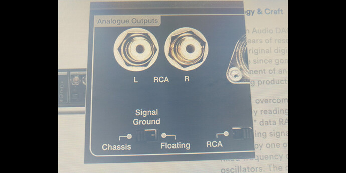

If my source is a DVD player with coaxial output into Naim DAC, can I connect these two RCA outputs from the DAC to the Sub directly ?
Thinking of using Velodyn or REL sub…
many thanks in advance.
No, because they are pre volume control.
