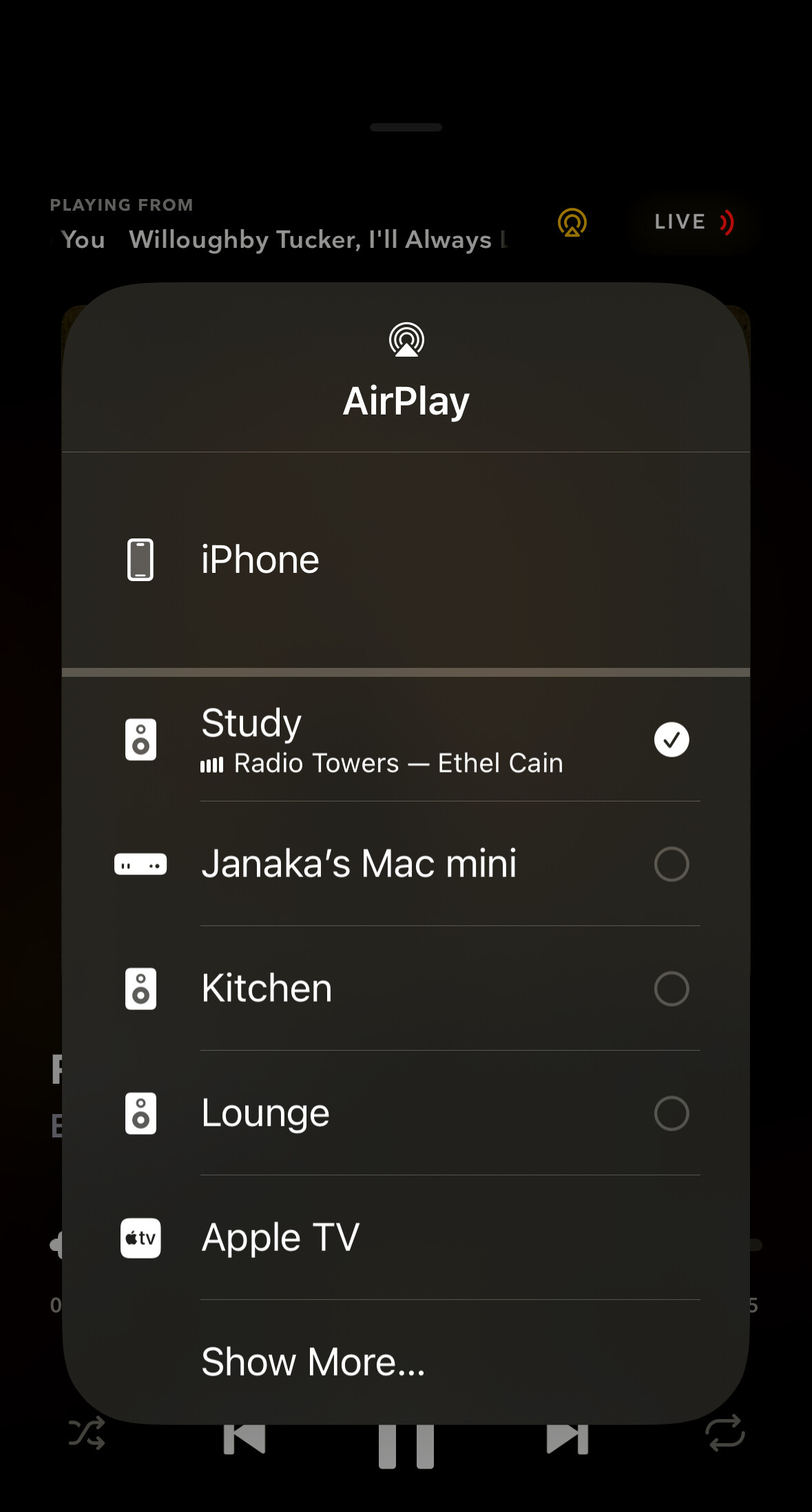

I have separates (NDX2 for streaming) in the light room, an Atom in the kitchen and LSXii’s in the study. I can have any two or all three devices synced for playback via Apple Airplay.
In the screenshot below I’m using Tidal through the KEF’s only but just need to tap on the other devices for them to join in, and you have a volume slider for each device. Would this method work for you?
