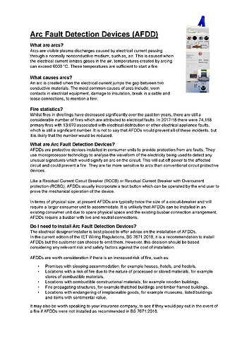

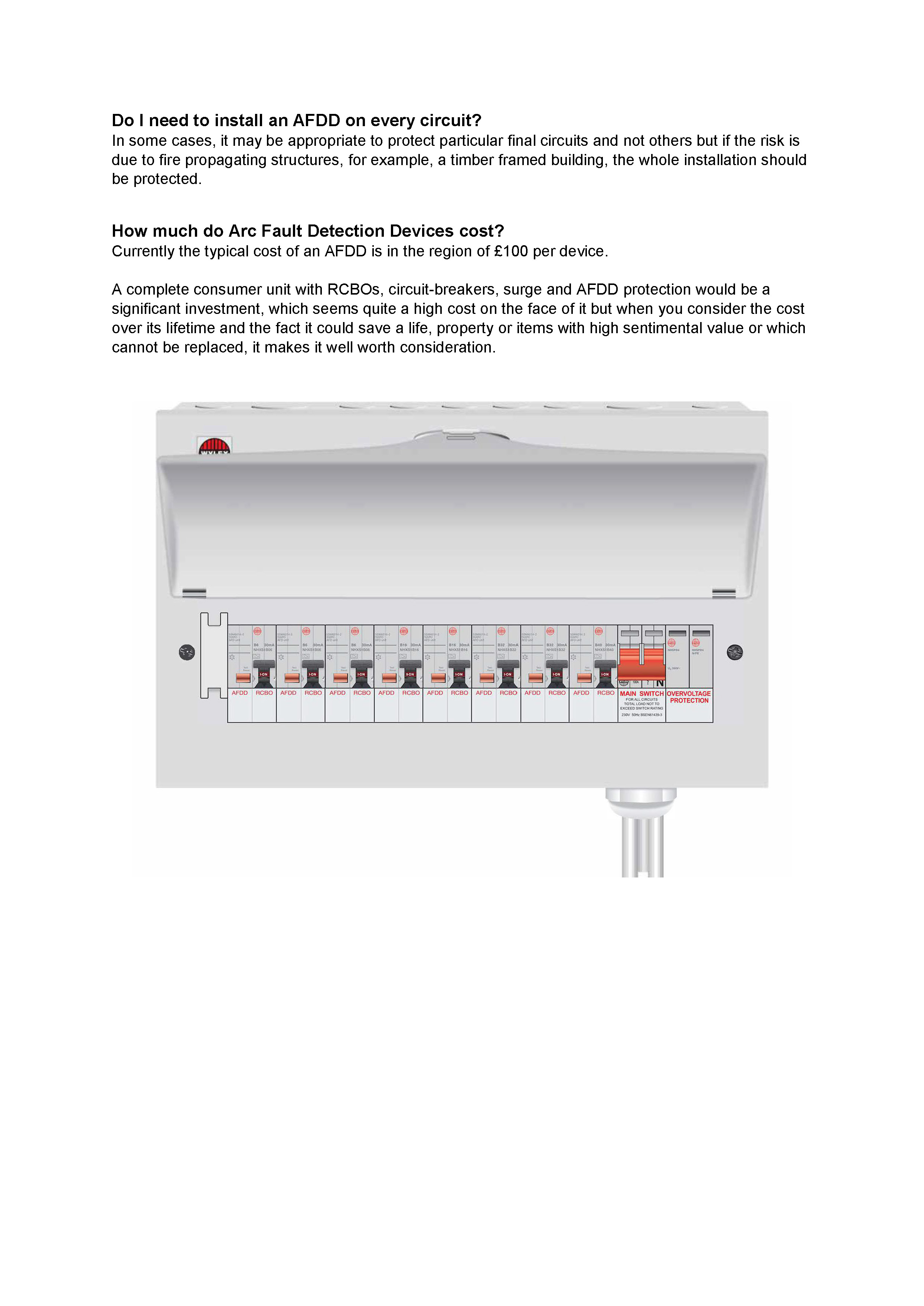

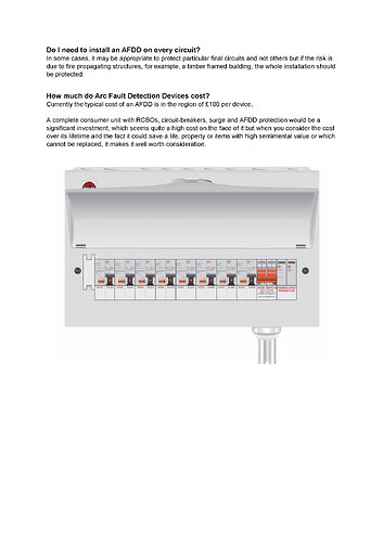

The IEE wiring regulations are not applied retrospectively to existing electrical installtions.
Please find attached information from the IET web site.
KInd Regards.
Roger.
