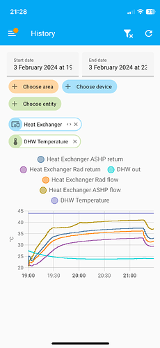

I constructed a Home Assistant WiFi temperature sensor (actually 5 on one interface). I monitor the flow in and out of the CH plate heat exchanger.
This is normal running.

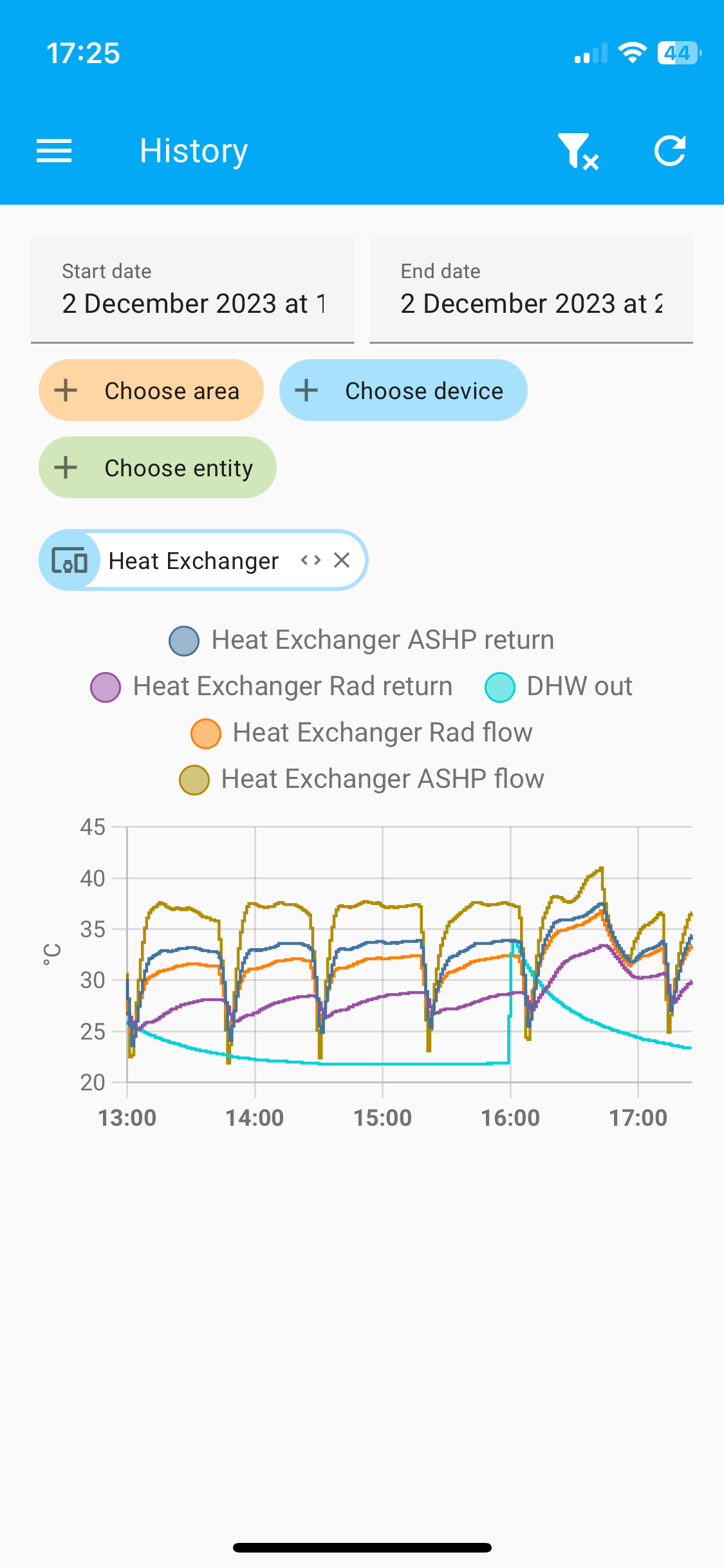

This is when cold.
To defrost the unit reverses the flow direction. It uses the heat in the circuit to defrost the external heat exchanger.
