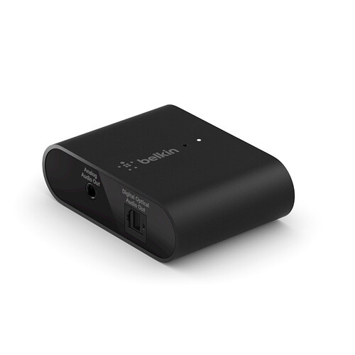

I found something like Audio Adapter with AirPlay 2 and it has an optical output.
what you think about this?
I think it is a cool device.
Thing is on my Windows machine I already have a solution to wire analog into the Atom. So considering the cost of a Macbook Pro I was looking to see if there was a solution on it that does not require an extra purchase.
