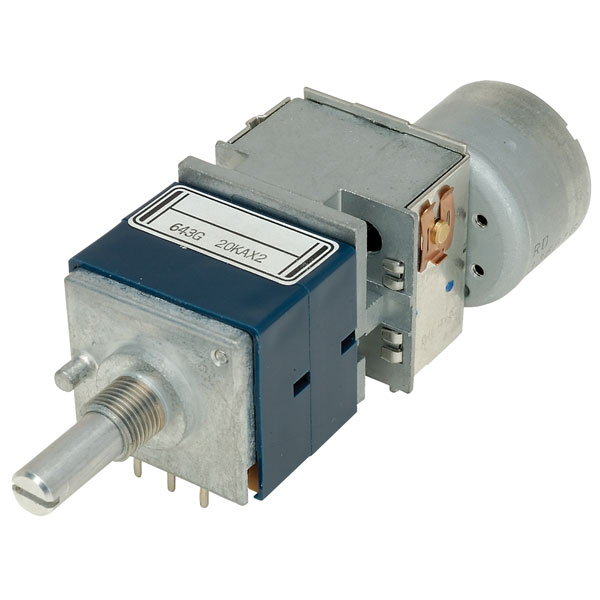

Given the balance knob issue, it could be your preamp stage / volume attenuation.
No/low volume when volume control is close to zero volume position plus a cracking noise when volume control is moved is indicative of a “dry” volume control pot. It’s might possibly clean up with a spray with switch cleaner, but I suspect will need replacing.
Volume control pot? Is that the big knob or a part inside?
Issue is the same when I control the volume from the app….
I see, in that case I should bring the SN3 to the dealer, or anything I could do myself?
You might find that rotating the volume control repeatedly up and down cleans up the contacts on the pot. (Obviously turn off the amp first!)
If this helps, it’s possible that the problem will return, in which case it will need to be serviced.
Clear, thanks. Worth a simple try!
It’s the part inside, it’s caused by a so called ‘dry’ section of the sliding electrical contacts.
It will be the same no matter if manual or app control.
It looks similar to this …..
I tried and also cleaned the loudspeaker cables and power. Sound is a lot better now on low volume, but the scratching noise when using the volume control persists. Most of my annoyance is gone :slight_smile: but I will contact my dealer anyhow.
