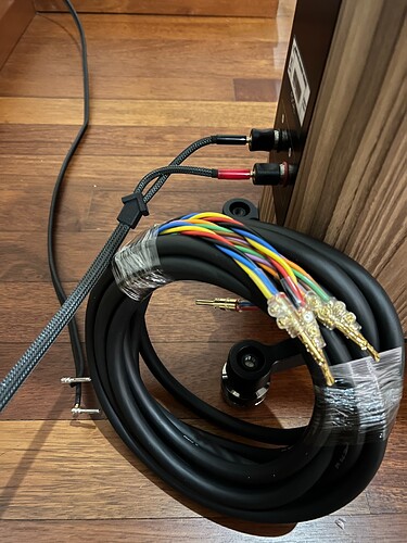

My speaker cable journey (250DR to Kanta 2) - from NAC A5 to WH Phantoms to Gotham 58025 to Mogami 3082 and back to Gotham 58025.

I have TQ Ultra Black II with Kudos 606 but I’m waiting to receive KS1 to compare each other.
