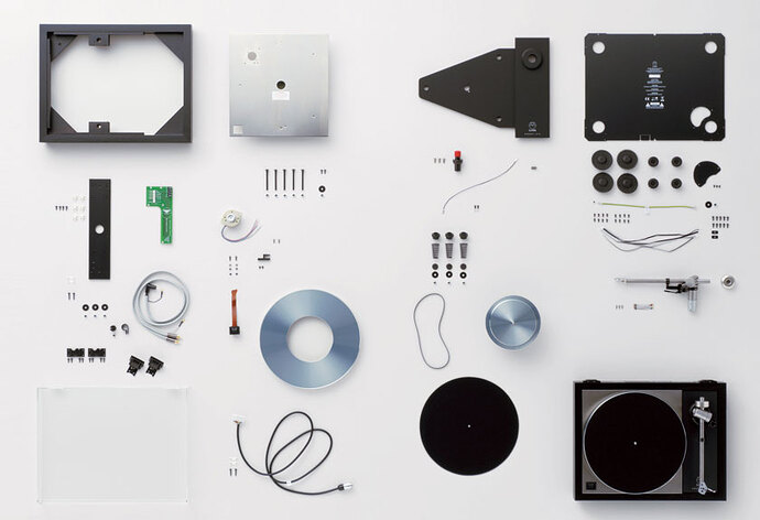

Sondek = Lego® of Turntable!
Every part is changeable. Whether it’s considered to be upgrade is depend on personal taste assuming

As far as I’m concerned the two biggest improvements were the Cirkus bearing and the Radikal power supply together with its DC motor. The Radikal can also be used to power a phono stage preamplifier called Urika, which is situated on the baseboard, which is a Trampolin type. The Radikal power supply is available in two versions with identical electronics, but different casework. Unbelievably, the machined from solid version sounds better, but comes at a cost, of course.
Another major mod is in the sub-chassis. I believe there are now three versions offered by Linn (as well as others). The Linn versions are the basic which uses a separate arm board, the Kore, which is pressed steel and integral cast armboard, and top of the line is the Keel, which is one-piece, machined from solid.

Apart from third party plinths, I think there have been four variations of the fluted design -
- the original with a slot in for the lid to be propped open
- the hinges for the lid were changed to a spring on so the prop was not needed, so no slot
- corner braces were added - if you shine a light into the gap between the armboard and plinth at the front right corner you should be able to see if you have corner braces
- an anniversary special edition to celebrate 45 years
There have been additions to the subchassis, welding, bonding, cross brace (I think all these were last century, currently there are Majik, Kore and Keel variants
Radikal is the top of the range power supply
The original baseboard was fibreboard, this was then changed to metal sheet and then to Trampolin that has “bouncy” feet.
Syrinx is a non-Linn brand tonearm
Cirkus is the latest variation of the bearing
