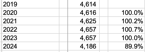

I’ve had my Solar Panels for 6 years now, and annual generation has been pretty consistent until this year. Interestingly I’ve noticed over the last year that the number of clear sunny days has reduced, and therefore I can mostly exclude reasons such as Inverter issue, or dirty panels (they still look clean).
The break down of changes compared to previous Month shows us where this 10.1% has gone, but the numbers are all over the place to get any real conclusion.
Anyway, my question is, have other people with Solar panels noticed a similar generation reduction in the last Year?
I’ve only had my panels for 18months, so can’t comment on long term generation.
Though I’m very surprised how consistent 2019-2023 was. I’d expect a +/-5% at least.
Do you have panel monitoring, such as SolarEdge? Maybe something useful can be extracted.
Those first five years are incredibly consistent and to see a sudden drop is strange. Maybe one or two of the panels has become disconnected. Our 16 panels are wired as three of four groups, so if sat two or three of yours are wired together, a disconnection would explain it. There should be a menu in the inverter that will show you what’s happening. Possibly.
No I don’t have that. Most my various stats are taken by taking reading every month, and the generation is from the FIT meter, so very accurate
@HungryHalibut my panels are in two groups of 9, so I may be able to get those stats, however it has seemed like sun levels have been lower this year. 10% reduction would suggest 2 panels. However once you have had panels for a while, you do start to watch the weather a lot more, and you eventually get a feel for what they should be producing, so in my head, it’s a weather issue rather than a technical issue. Anyway I will see if I can get any stats, although unfortunately the original app used was retired a while back, and in transferring over it lost the history, so it may be limited

Just checked the two panel groups, and they are pretty similar, so that’s good news, but also a worthwhile check, thanks
My 2024 output was down about 8% or 9% compared to 2023. June 2023 was a very good month, with 980 kWh. I have 16 panels split over two roofs (11 and 5). While my panels are 420W DC, each has a 300W AC microinverter. So each panel generates independently. That is, there is no string inverter. Yes, there is an initial cost, but I’m still surprised they are not fitted as standard now. Anyway, as noted, my output was down in 2024, with July being particularly poor.

Panels 6002 in year from 30 Jan 2022 (day 1) and 5500 upto today. So 8.4% down. There will be less AC from inverter. I have 15 panels of 420W with SolarEdge string inverters on two strings. Roof faces 160 degrees so nearly south. The neighbours although 30-40m away to the south do shade until 9am at this time of year. We are a chalet and they are 2 storey.

Many thanks everyone, so to summarise
@Thegreatroberto down 8-9%
@trickydickie down 7%
@Ian2001 reduced crops due to lack of sun
@Filipe down 8.4%
Me down 10.1%
So I think it’s clear from this extremely broad survey, that the sun has gone into hiding.

We generated 9.6 MWh in 2023 and 10.1 MWh in 2024, so the variation seems reasonable for you I think.
