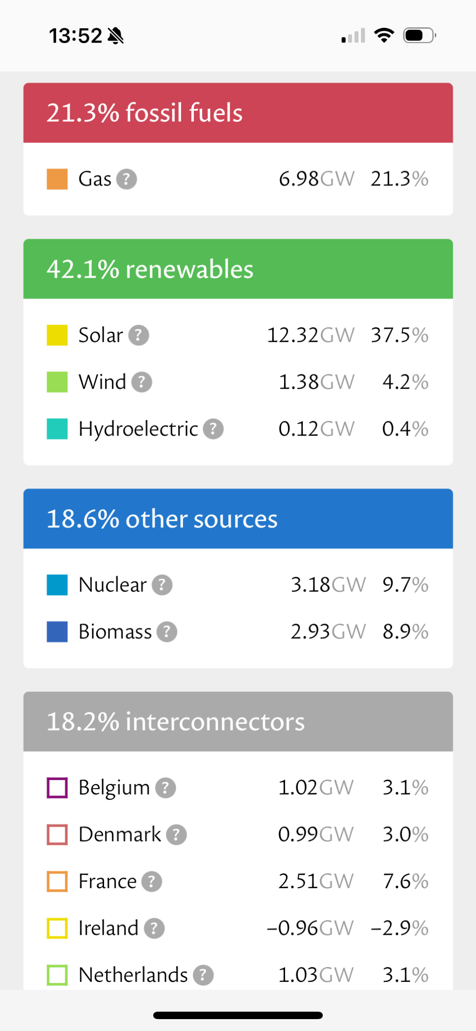

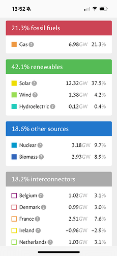

Nice to see that solar can, in some conditions, make a significant contribution to UK demand when there’s not much wind.
courtesy of iamkate.com
I do hate seeing that gas figure though. At least us solarites are helping.
Yes, but it’s that biomass figure that really bugs me.

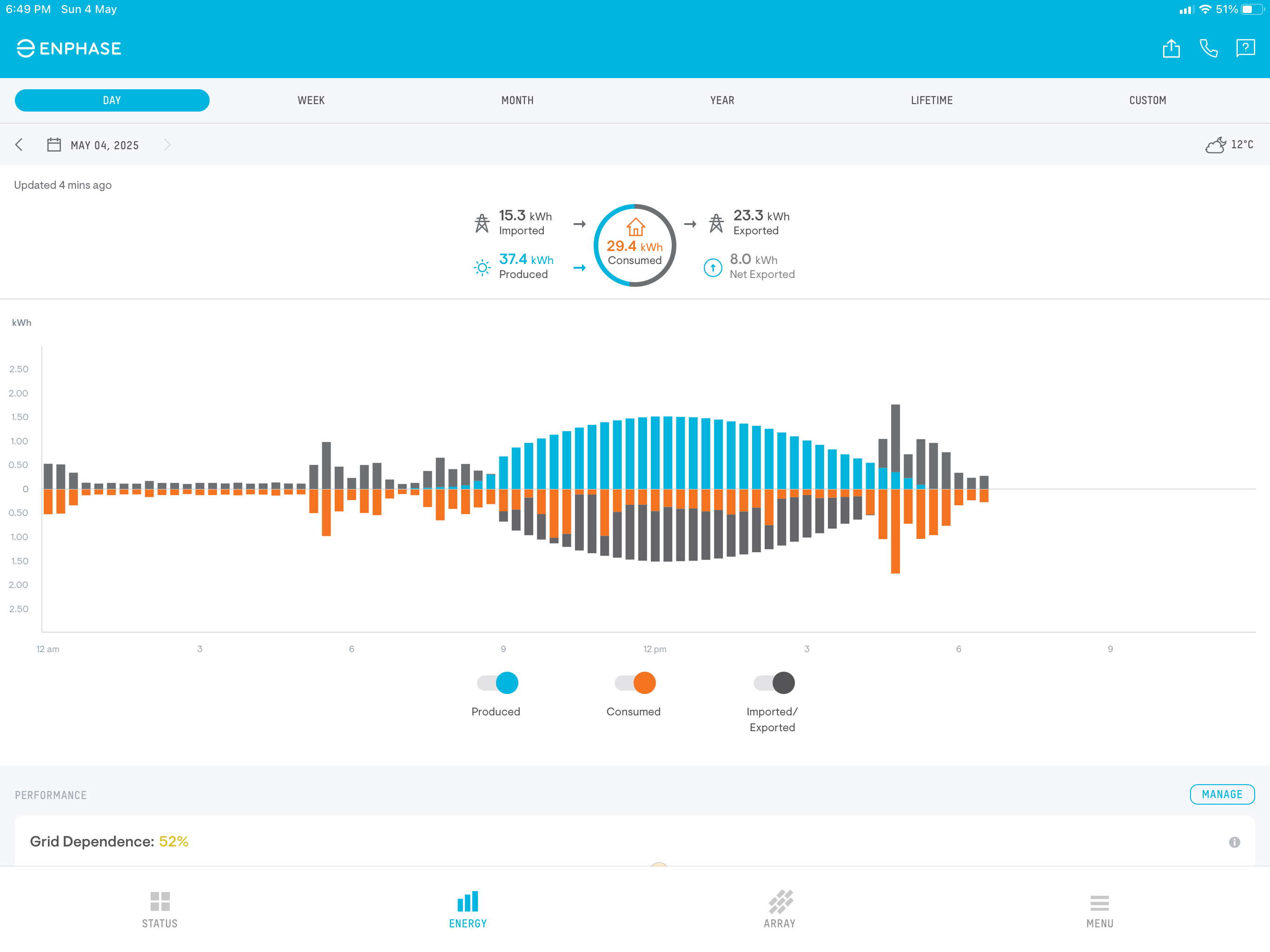

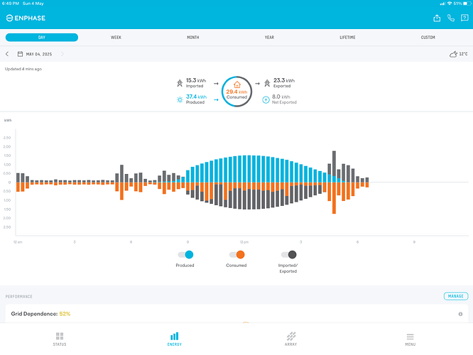

37kWh is pretty good for May here in NZ. We get a nice long flat curve as well thanks to our NE and NW arrays.

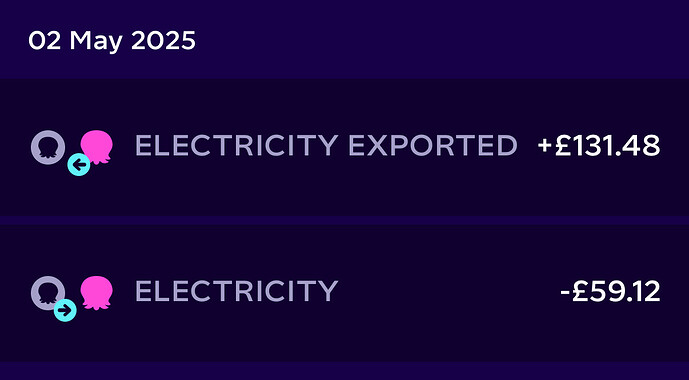

We generated 923.8kWh in April, and this was our April bill (3 April to 2 May).
I’m really surprised how it worked out, as I thought balancing the books would be a good result. It’s particularly pleasing given that it covers everything, with no gas heating, as well as charging the car.
Isn’t it a nice feeling, after making such an investment for environmental reasons, to see the electric bill approach zero over a full year.
