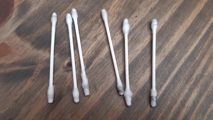

Did it. One of the q-tips fell off in the hole. No problem getting it out though. I didn´t listen before, but imagine a cleaner top end after cleaning. Q-tips were quite grey so they removed something.

If anyone clean the speaker outputs then please post a picture of it :smiley: I’ve ordered cottons sticks and will give it a go at some point.

Err? You lightly dab the cotton bud in some IPA, you clean socket. Use the other dry end to do the same, because IPA actually leaves a white powdery deposit - whist doing so it should squeak. Where is the waste? Been doing this for years.
P.S. When i do mine i dip the cotton bud in some IPA and then roll it briefly onto some kitchen roll before cleaning, because you don’t want the cotton to be sodden.
