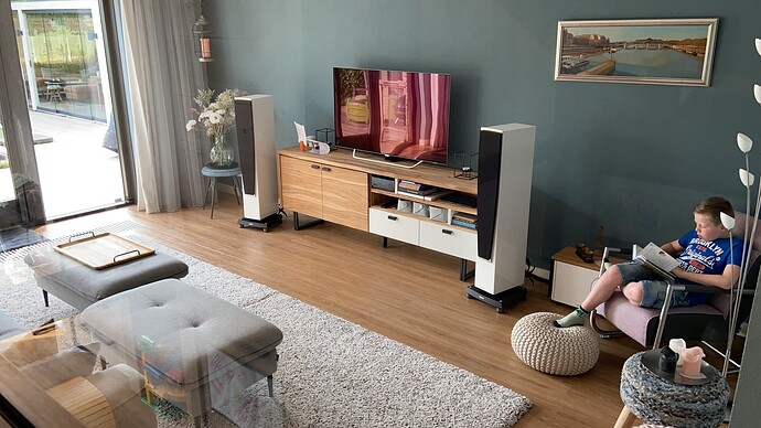

Indeed. :slight_smile: I have been driving my Dynaudio Contour S 3.4 LE (floorstanders) with the Atom for some time. That went really well. Adding a NAP200 and later a Purifi power amp added authority to the sound. The characteristic stayed pretty much in place, due to the ATOM preamp I guess. So give it a try and you can always add a power amp later.

Again, I would not rule out the Atom too quickly. Give it a try as you might be surprised. In our case the Atom was more than capable to fill a large living with sound (even at high volume) driving a pair of Dynaudio speakers.
