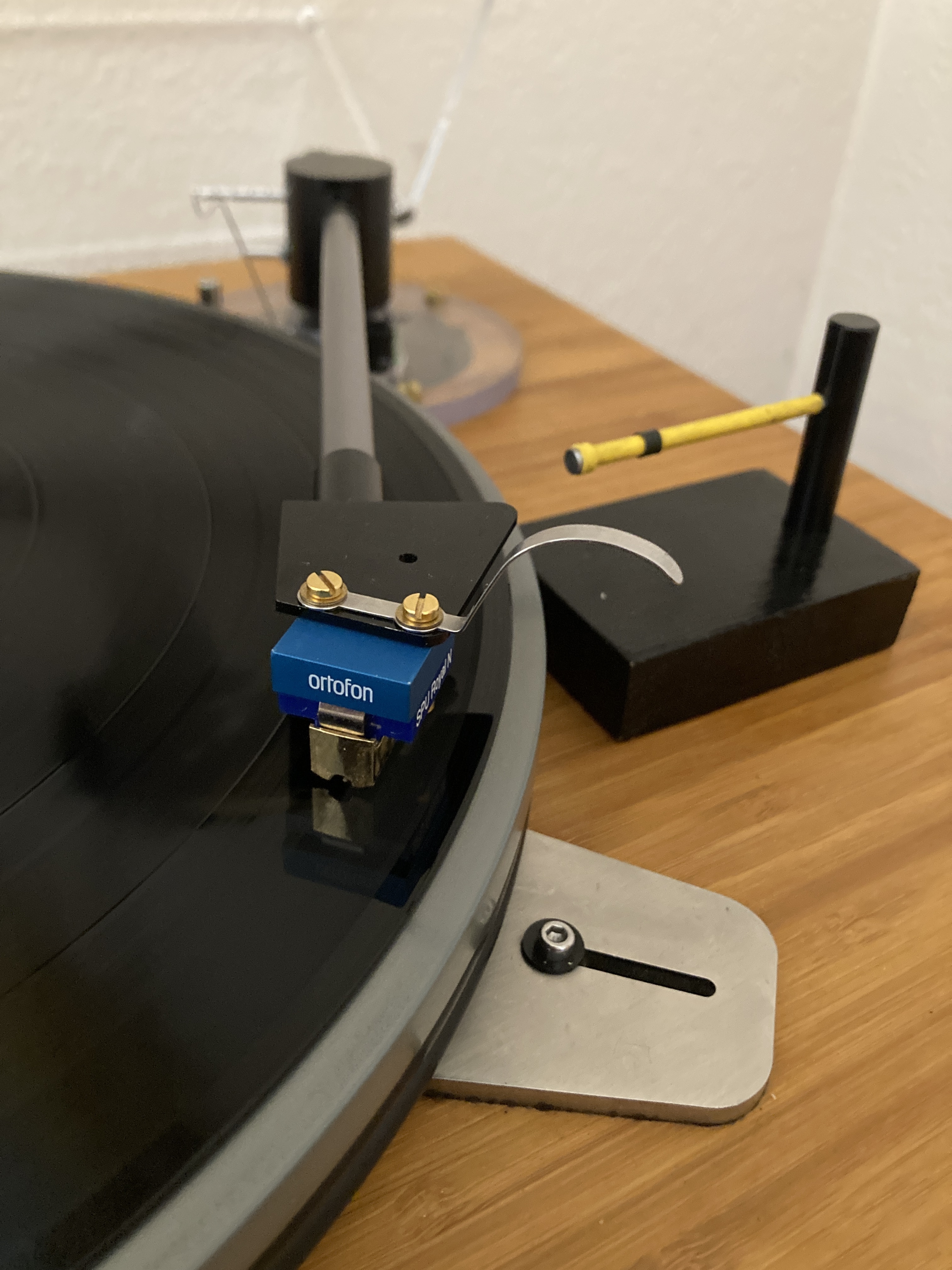

If you’re running an SPU N you’re either a fair way off optimal overhang or you’ve adjusted P to S for the Aro. I made a new arm board to use my SPU Royal N on my Aro and got pretty good alignment to UniDIN geometry when checked with a Smartractor.
The Aro is a bit on the light side however, shame there isn’t a brass spacer available for the SPU Ns (there were some made in Japan I think).

I had a special armboard made by Loricraft for the ARO so that there was adjustment that could be made.
