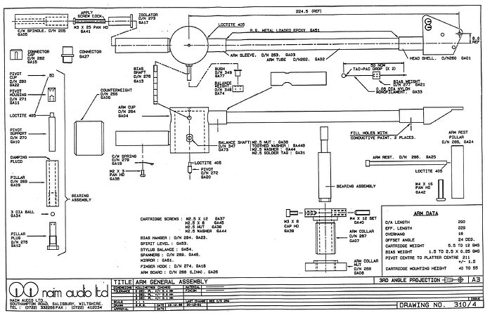

I’m not aware of such a thing. There is a technical document though which gives you the info you need - particularly the pivot to spindle measurement required for mounting.

Thank you Richard that tech drawing looks intimidating–gulp!–will enlarge to A5 and study to see if I can use that information -thank you for the prompt reply.
Diver411
All you need is the pivot centre to platter centre measurement - 211mm (+/- 1.5mm) - to allow you to correctly drill the hole.

Indeed with fixed placement on all Parameters only one measurement matters for the Arm positioning yes!– I see that now.
The venerable KISS formula to the fore–fine I’m sorta clear now I think and ready to undertake the setup.

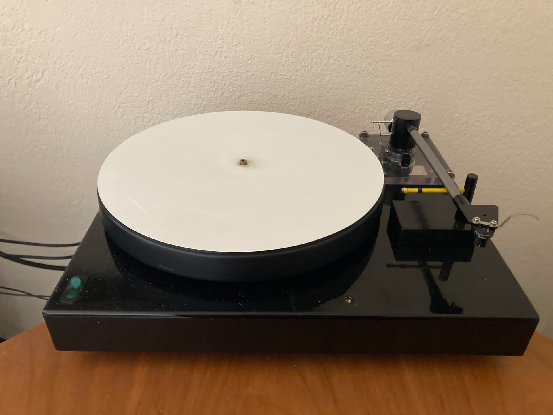

Here’s mine on a stripped down mk2 Townshend, sans trough and clamp while I experimented, successfully, with a TEAC mat.

Grateful for the info-yes I did ponder that question you outline will see how it goes as I progress into attack mode–sure is a quirky devil–I thought my Breuer’s were a handful to setup –this may take the cake!
Much appreciated the help –thank you for the snap –nice setup ,ah yes the dear old Max’s TT the Sand Groper from Western Australia!
