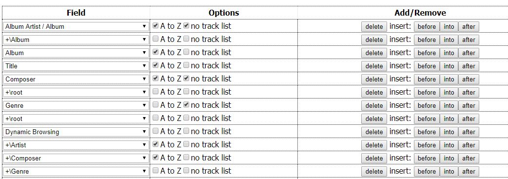

I added Album Artist / Album to the top of the browse tree (and moved Artist / Album to the bottom). That’s how I prefer to browse to find my albums.

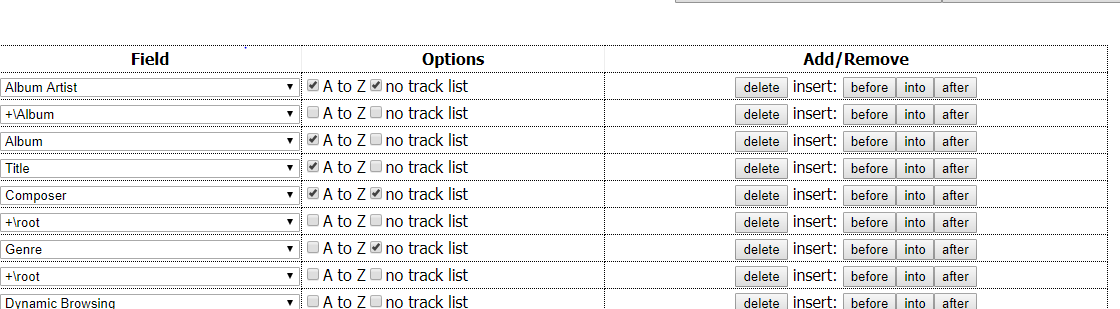

Can you post a screen print of the browse tree with that ---- just to be sure for an Asset newbee

Asset has an option to display copy and paste and edit the browse tree in text format at the bottom of the config page so you can copy to a text file for backup or even sharing it here.

Hi Mike
Here’s a snip of the Browse Tree edit function from the Configuration screen.
I’m going to have a go at changing it slightly. As it stands this presents the albums in a-z order under the album artist. I’d prefer to have them ordered by year first (although I don’t suppose my metadata is anything like complete for this).
Is this what you were after? Or did you want a snip from the app view?
Can’t see anyway to order the albums under album artist by year. Will see about asking on the Asset forum.
