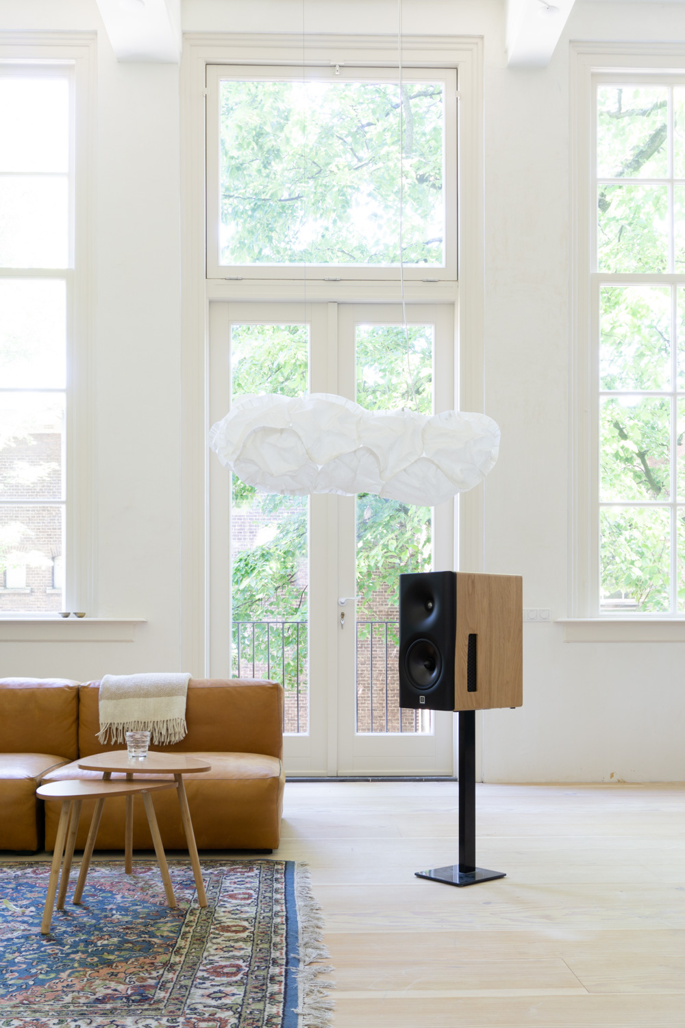

Another active option you might find interesting is the Dutch & Dutch 8c, it’s a more modern implementation but it received some really good reviews the last few years.
They go down to 30hz so they are full range (the SCM40 stops at 48hz).

Dutch & Dutch are often cited when you talk of active speakers but they have a dearth of dealers :frowning:

As a passive ATC SCM40 owner, if I were contemplating ‘going active’ I would certainly include the current round of DSP active speakers such as the Dutch & Dutch or Buchardt as they are a good deal more sophisticated than the ATC ‘analogue’ actives.
It looks like, well certainly for the D&D speakers, that there needs to be a site visit by the dealer to measure and create a filter to upload to the speakers - have I got that right?
If that’s the case then should you really need to wait until said room is finished (furnishings/floor/&c.) otherwise the characteristics will change as you alter the acoustic element of the room?

I listened to Dutch and Dutch 8C on 3 occasions and was very interested . They do sound very good indeed but I wasn’t overkeen on their connectivity or their looks as they have a large footprint . I also felt that there was also a lot going on inside with multiple DAC’s / DSP etc so ongoing support and back up might become a worry because they aren’t cheap either . I do think they are very good speakers though and it’ll be interesting to see how that company evolves .
