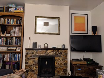

That sounds more like it should be. Now, I don’t know if this has been asked, but can you reorganise things so that your speakers are at ear height rather than ceiling height? I’m not sure it’s worth trying other speakers until you can get them better positioned.
That positioning, in this case, is actually preferable as the off axis response of the tweeters is slightly softer resulting in a more pleasant and balanced sound. But for sure I will try alternative arrangements with a higher end pair of speakers.
I had a bit of a shift around last night and speakers are now about a foot lower down, which is about as good as its going to get when taking into account the wife acceptance factor.
