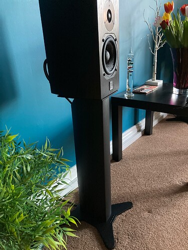

I’ve got a pair of scm7 on demo at the moment in comparison to my evoke 10 and curious how people have them in their rooms and distance from back wall. I’ve put them on dynaudio stands currently 23cm from the wall (to rear of speaker) and appreciate they are brand new but the bottom octave is mostly absent. The Dyns are a bit to much so I was hoping these would work. The reviews I read said that they did fab bass for their size and whilst some is there and it’s fast and tuneful I would not mind a bit more (sub is not an option in the lounge) . I’m move them to about 10 cm later and see what gives but would appreciate what others sets ups are. Driven by Supernait 3 and nd5xs2. Should add my room is 3.5 x 4.0m

I know tech measurements don’t always tell the whole story and I don’t have any experience of atc but reading the spec sheet the scm7 are -6db at 60hz. That is quite a drop off from where their midrange will be. Hungry halibuts tablet 10s are designed for close wall placement- recommended proac in their brochure. Atc recommend positioning their speakers 1m from side walls and 2m from the back wall. They do also say if the bass is light to move them back slightly but really 2m out is serious domestic trouble territory. It would be interesting to get some feedback from atc themselves.
To find optimum speaker -and, equally important, listening - positions I would use REW software with a measuring microphone - far quicker than trying to do by ear, as assessing each position takes seconds and shows exactly what is happening.
However, with a spec showing them 6dB down (quarter loudness) at 60Hz, I wouldn’t ever expect to get the bottom octave at anything like realistic level. Hard against a wall would help, even more so right in a corner, though not sure what that would do to upper bass.(REW would show.)

Not much help since I have them out about 3 feet from the wall with slight toe in while located the room downstairs where they are in use. If I had them in the my living room up stairs I would have them about 12 inches from the back wall.
The sweet spot should be somewhere between 10 and 15 cm. from the wall, depending on your room, furnishings, preferences, and so on.

Thanks for all the replies chaps. At the moment I have settled on 13cm out and 1.8m apart with toe in. The bass is developing and the treble has softened a bit but they are a lively bouncy speaker. I put some test tones through them and could just about sense output at 31.5 hz and clearly audible 45hz so pretty darn good. They are on dynaudio stand 10 filled with a tub n half of atabites in each so darn heavy!

Might be worth noting that ATC recommend that our ears are on the axis which lies between the tweeter and woofer, so stand height will important.
Stands which are too low will tend to emphasise bass, all other things being equal, because the woofer is closer to the floor than it would be on taller ones.
