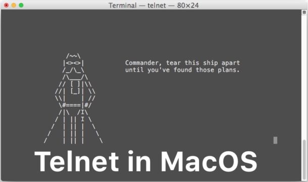

Being able to use the web or to telnet or SSH into a Cisco switch to trigger the initial configuration dialogue depends on the switch config having being wiped first as far as I know. And that wasn’t clear to me from the OP whether that had been done. But if you tell me otherwise then OK. BTW telnet is no longer installed natively on OS X, although you can find downloads.

Yes real backward step in the latest OS X versions, but easy to put back in

Yes - annoyed me when they did that.
You can use HomeBrew to install it from within Terminal
/usr/bin/ruby -e “$(curl -fsSL https://raw.githubusercontent.com/Homebrew/install/master/install)”
brew install telnet
