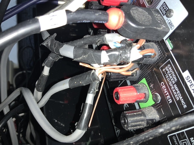

I have just moved into a house that has a dedicated cinema room ( used for storage while we are getting straight so ignore the mess !) which is set up with questionable stuff I would say. Projector make I have never heard of, speakers in the ceiling are non branded so no idea what they are (complete with electrical cable as speaker cable) but does have an onkyo amp. I have it up and running and it sounds as you would expect although picture is “ok” I think it could be better. I am not a TV person at all so have no idea about AV side. Has anybody got any good ideas/suggestions that might work at all please ?

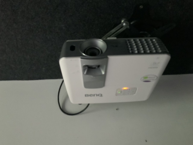

Benq used to be the AV division of computer brand Acer, which was made into a separate company about 20 years ago. It’s a decent consumer-level brand but not really focused on high end gear.

BENQ projectors are pretty decent for the money and readily targeted for the RS crowd - that one was around £700 when new but is a few years old now.

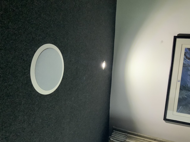

The ceiling speakers alone will sound horrendous, however pair them with a 5.1 speaker kit (making 5.1.2, the .2 being Atmos) and they will sound better. But they do look to me Amazon-jobby ceiling speakers so won’t be fantastic.
What’s the make model number of the amp as you will need something that supports Atmos channels to run a 5.1.2 setup. I’m guessing its a cheapo one based on the standard of wiring and what’s been used for ‘speaker cable’ !!!

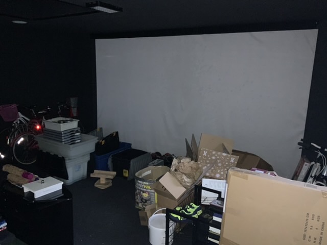

The screen has more kinks in it than a 60’s disco so I would install a fixed-frame one for a better picture.

For Dolby 5.1 you wont need celling speakers, for 7.1.2 you will need ceiling (aka. Atmos) speakers.

@gav_sw20 thank you, you have confirmed what I thought about what I have. I was thinking of ripping it all out and starting again which is sounding more and more like the best option …

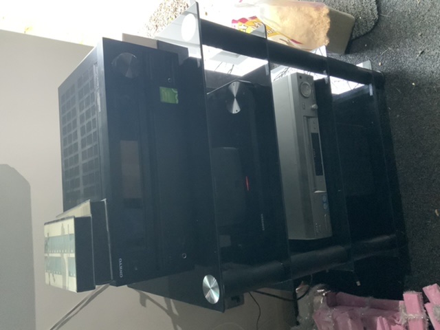

The Onkyo AV Receiver is probably reasonably decent for the money and well worth keeping initially to see how it fares with some real speakers properly connected with speaker cable, and well set-up and positioned. Do you know which model it is?

@Richard.Dane Thanks richard it is a TX-NR515. I hope that means more to you than me !
As @gav_sw20 advised upgrading the screen will be really important, a good screen will cost you somewhere around 1000-2000. A good beamer to go with that will cost you between 2500-5000, depending on the type/technology and brand.
Something like the JVC DLA-N5 is killer for a room like that, but it would set you back somewhere around 6000,- for the beamer alone.
There are different types of screens that work best with different types of beamers, so this is something to consider carefully.
BTW - the projector looks like a BENQ W1070, it’s 1080p and 3D and still worth £200+ on the auction site / AVF.

By all accounts it’s reasonably decent for what it is. I stuck the model number into google and it came back with a few reviews, most very good. I’d say it will do for now while you try to sort out the more critical issues with the whole set-up, which will almost certainly be down to the in-ceiling speaker system. A decent 5.1 system that will allow you to really enjoy films need not break the bank and should elevate what you have to a much higher level. Then you can decide whether it’s worth going further, where expenditure will increase dramatically.
Oh, and properly calibrating the set up of the projector will make a big difference to the picture quality. However, note that you need to get the room as dark as possible.
