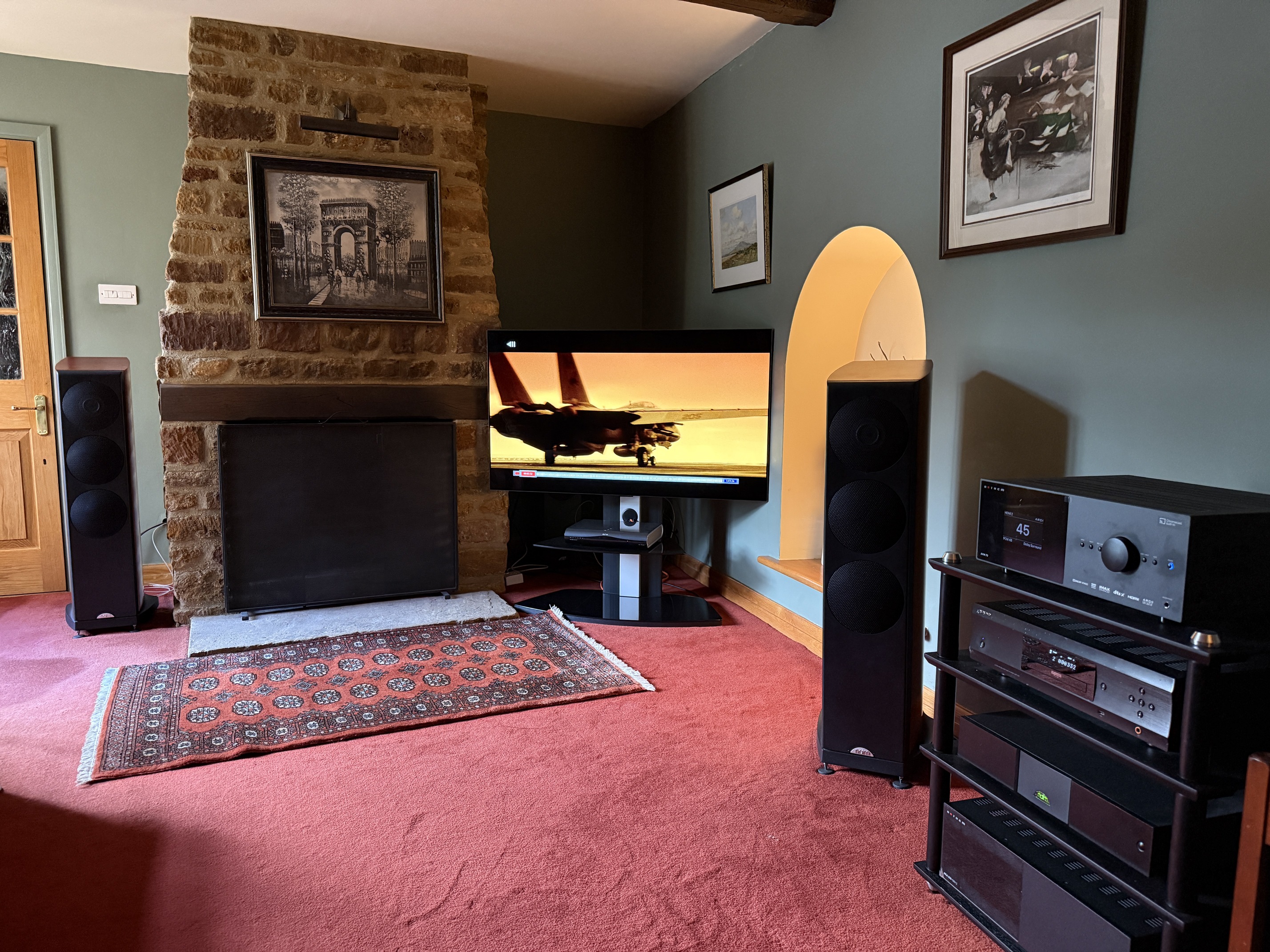

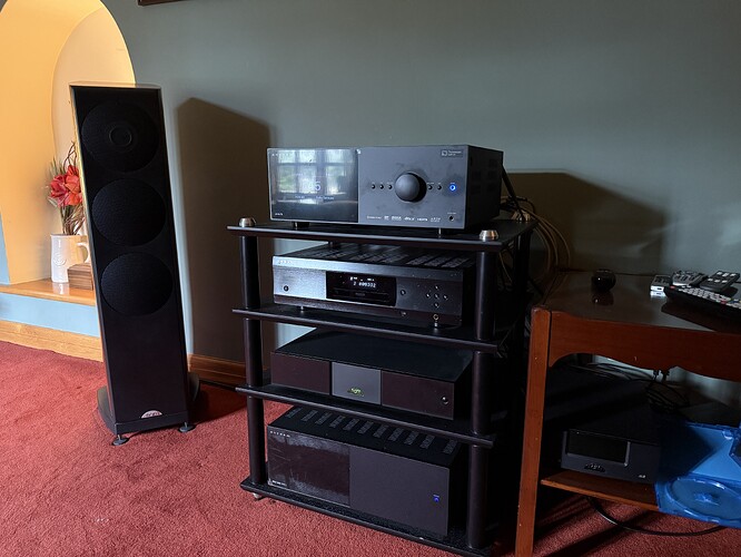

Few pics to illustrate the system.
Front speakers just back from crossover service.
Centre S400 + REL, usually hiding behind tv; cable dressing wip!
Viewing angle (no socks). One of my original DDs was Top Gun, this the 4k version of the original.
For the eagle eyed, a UQ2 for streaming duty / multiroom, connected by digital to Arcam.
