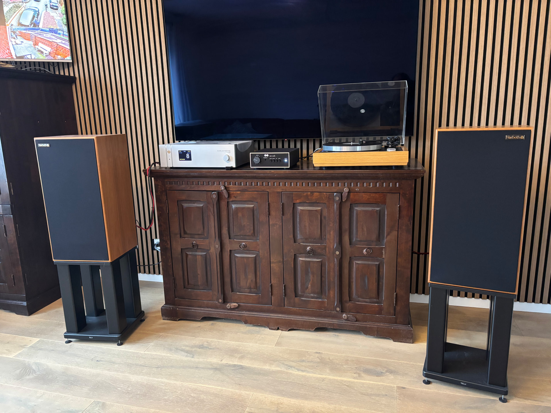

My name is Oleg and I’m from Bremen, Germany. I used to own Naim equipment, but then I switched away from Naim. For the past 4.5 years, I’ve had Linn Majik DSM/3 speakers and Audio Note AN-J/SPE in my living room. Then I bought a pair of beautiful Harbeth SHL5 Plus 40th Anniversary speakers, which were always my dream speakers, and a Gold Note IS-1000 Deluxe. I’m actually quite happy with the sound. The Harbeth speakers are gorgeous. But, but after I bought a Naim Nait 50 for the bedroom, I want to go back to Naim. I definitely want to keep the Harbeth speakers and trade the Gold Note IS-1000 Deluxe for Naim. I’d prefer the Naim SHL5 Plus because I could get €2500-€3000 from selling the Gold Note. I’m dreaming of an SN3/NDX2 set again, but unfortunately, it’s still too expensive. I’d rather not pay double right away. My question to the community is: would the Harbeth XS3 speakers plus a streamer like the Wii M Pro Plus and later the NDX2 be enough? Or SN3 + WiiM Pro Plus? I absolutely need a phono input for the Linn LP12. Or do the Harbeth turntables require a lot of power? Alternatively, a 272/250 combo, and later replacing the 272 with a 222. The problem with the 272 is the lack of Qobuz and phono support. My room is 33 square meters.
