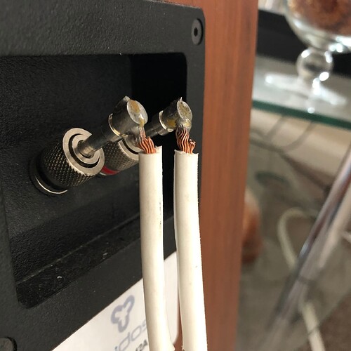

No, like this:
These ends would benefit by being re-soldered (*), as there are clearly several broken strands visible.
But for testing, they will do for now… :grin:
The Naim plug ends are in much better shape, as the solder joint is protected more.

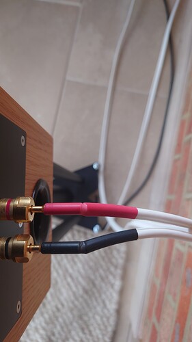

I used red and black sugru mouldable rubber/glue over each of my uncovered plugs - you mould it and sets with 24 hours- brilliant stuff
A bit of Red and Black heat shrink will tidy up the ends, plus will help to prevent any potential incorrect plugging into the speakers
Well, its done… My dodgy NACA5 ends have been re-soldered, using my new 100W iron… :face_with_spiral_eyes:
But - as soldering jobs go, its a significant challenge. Or it was for me.
I am quite happy working on smaller things, with my trusty 30W iron - such as interconnects, even those 5 pin 180 deg DIN plugs :astonished:
This… is in a different league. I guess if you do it more often, you should get better at at…? The problem lies with the NACA5 cable, which sucks up the heat, gets very hot, quickly - and starts melting/burning its insulation. Its also difficult to get the cable strands to stay together and ‘fit’ into the slot in the 4mm plugs.
Hmm… I wonder… maybe my 100W iron is designed for Lead Free solder and so is set to a higher temperature…? Possible. (I was using ‘normal’ Leaded Multicore.)
Any how, its done - and everything still works… :crazy_face:
