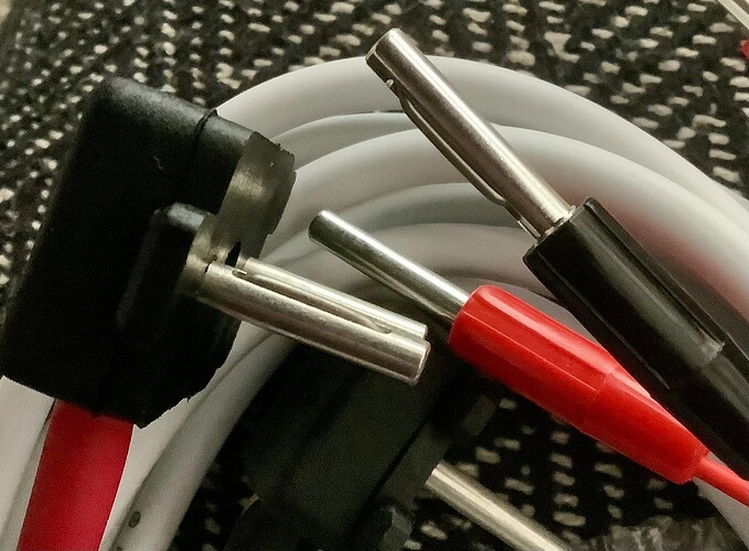

I now have Naim plugs at the amp end and standard Deltron at the speaker end.
The pins on both Naim connectors and Deltron plugs look identical the only difference being the Naim orientation for the lead out is different the Deltron plugs come out straight.

I use Deltrons the pins look identical to Naim plug pins bar the orientation.
