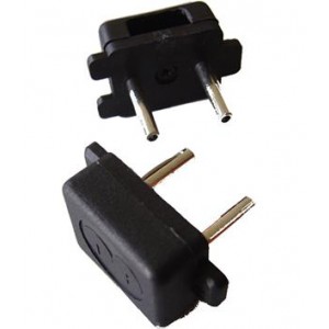

Deltrons are good, but for some speakers I find Naim plugs to be ideal. The right angled design can be a problem on amps as it often sends the cable directly down onto the shelf and a couple of very tight 90° bends are the only way to keep it clear. On speakers the Naim plugs send the cables down towards the floor, where you want them, instead of sending them out into mid air, which puts more strain on the sockets.

Thanks so much everyone. Chris, do you mean the double bananas that come with Naim power amps. I had not thought of that but should check if they might be the right spacing for my ATCs.
They are 19mm spacing which is the same as many loudspeaker socket assemblies, so it can be a good option (unless the sockets are very close to the floor.)
It’s also possible to use then without the black plastic box, so different spacing need not be a problem. Best to protect the plugs with a bit of heatshrink or similar in this case to reduce the chances of shorting.

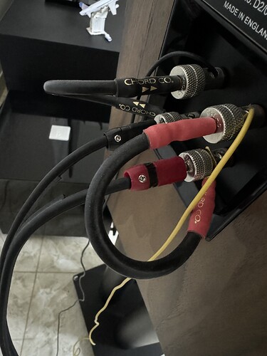

Happy with AQ Suregrip 300 along with Chord signature jumpers. Cables bought from Signals originally installed AQ Suregrip 100 at speaker end and SA8 at the amp end.
What’s the additional Black and Yellow cables?
DG…
I know it’s repetitious but I get £1 for everyone who follows this link.
Not.
These are the cables going to the high level connection on REL T9i.
