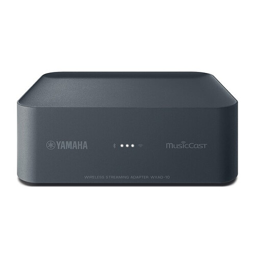

I use a Yamaha MusicCast WXAD-10 in a second system an it works well and has more features which may appeal to you. It doesn’t cost too much more than the Belkin device.

I’ve used the Yamaha MusicCast stuff too, and it’s essentially a complete streamer at a much lower price than Naim’s, so another viable option.
