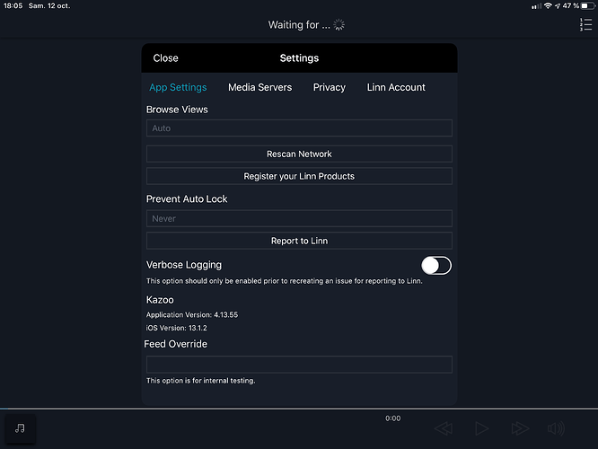

thanks, i will try linn kazoo. Mconnect crashes every 2 or 3 minutes.
kazoo is not working at all. no big problem. Just wanted to try.

the only settings i see are like that
i can just select my melco
It can’t find your NDS. My ND5XS is found promptly and plays 24/192 without dropping out.s
Looks like you may have a Wi-Fi issue.
If I remember correctly, don’t you need BubbleUPnP server for Kazoo to work correctly with Naim streamers? You certainly do with Mac
You’re right. When I tried Kazoo a few minutes ago it must have picked up my Bubble Server.
