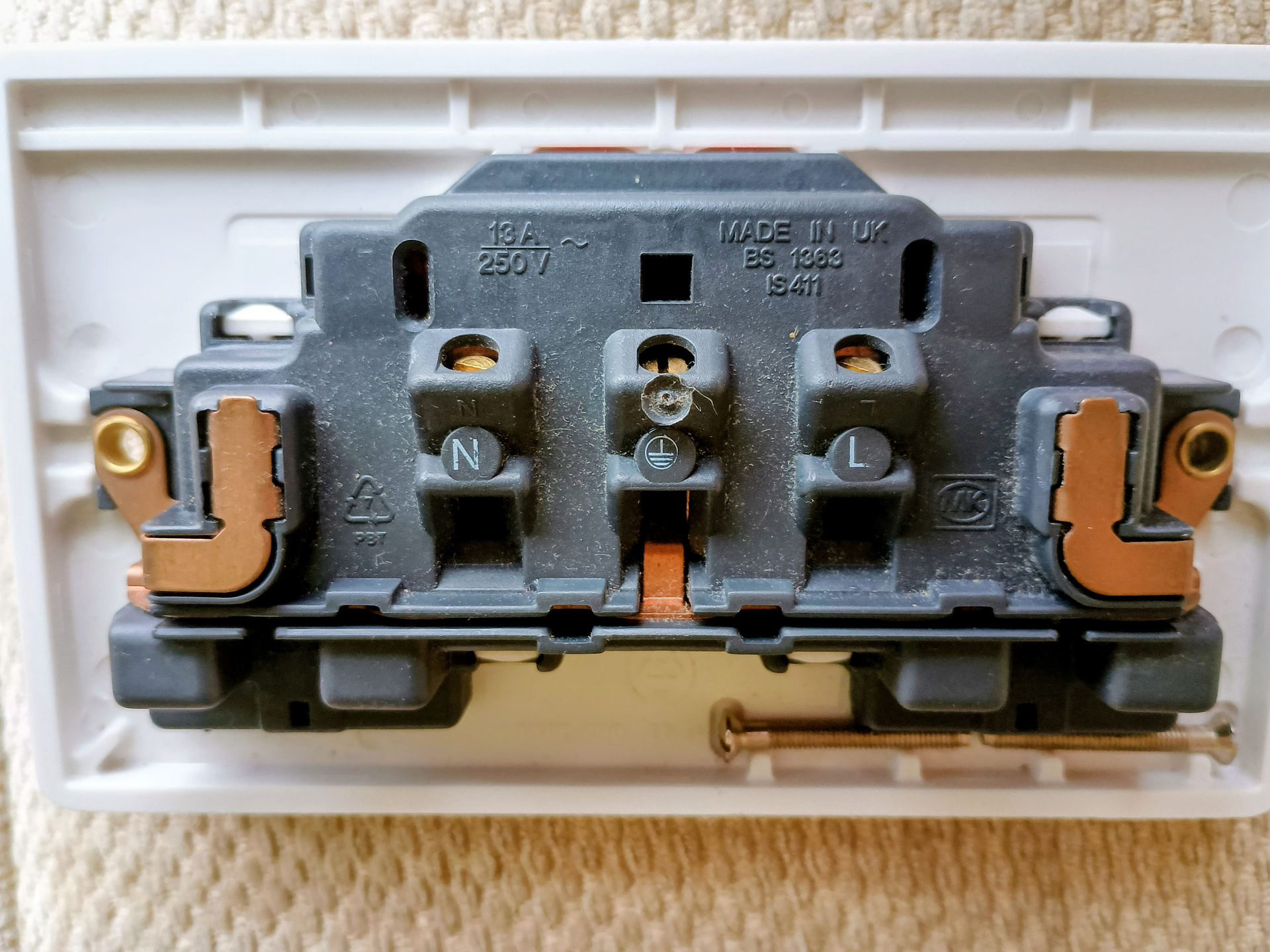

I replaced all my sockets (& switches +++) with MK some years ago.
This is my last remaining left over from that and is clearly marked “Made in UK”

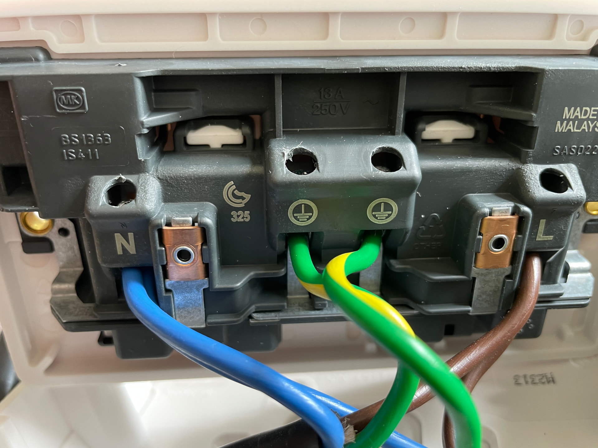

All I see these days is unmarked or Made in Malaysia and no question they are not up to the same quality. e.g. a new cloakroom light switch does not click at the same time when lights go on or off, it drives me nuts.
The pictures I posted above the top one is made in Malaysia and I have another identical made in the UK.
It’s Malaysia ones I’ve got just now.
Indeed, MK stopped making them in the UK years ago. When I rewired the house I used Crabtree switches and sockets which I much prefer.
