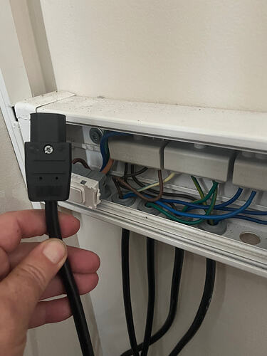

They don’t need to be individually fused,

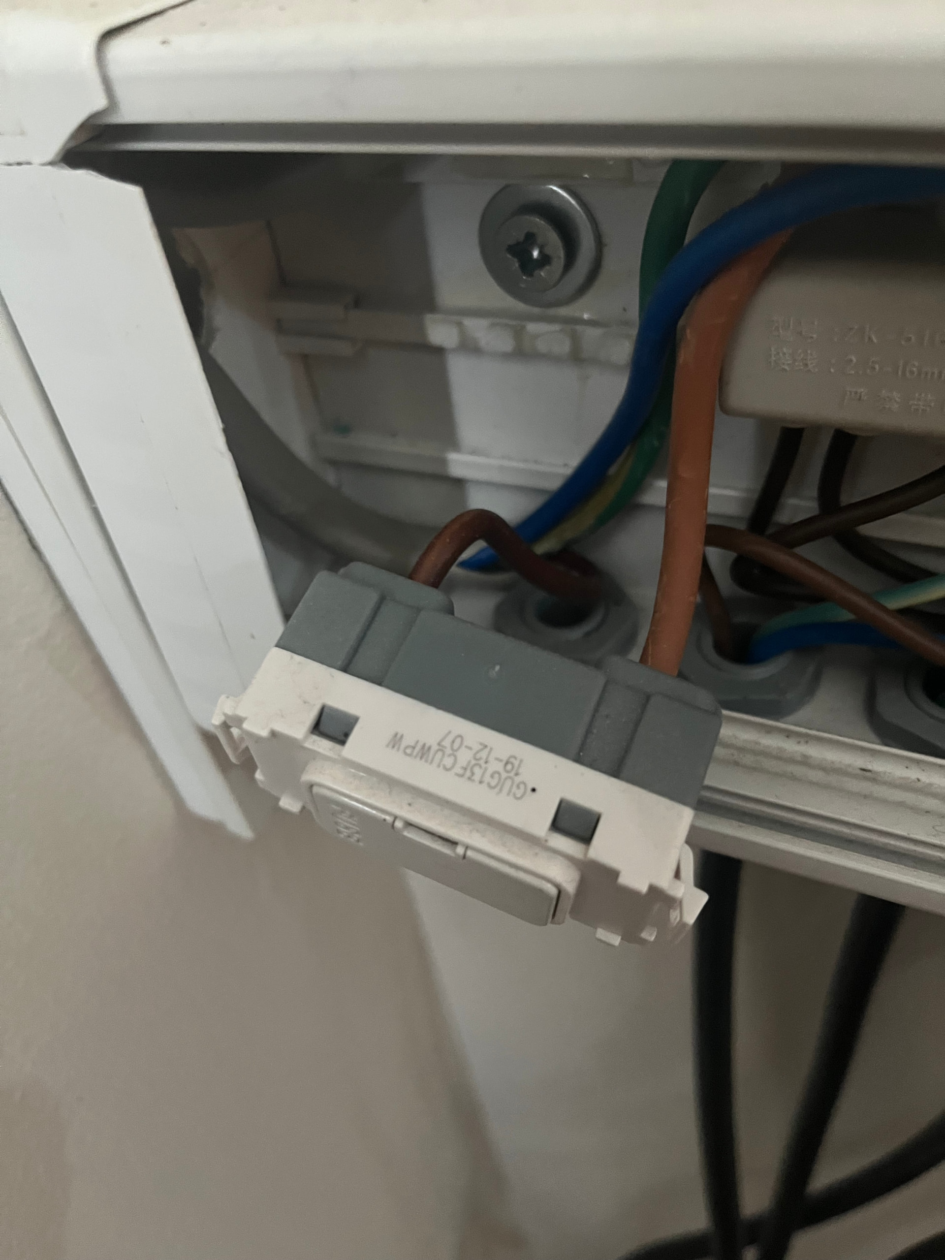

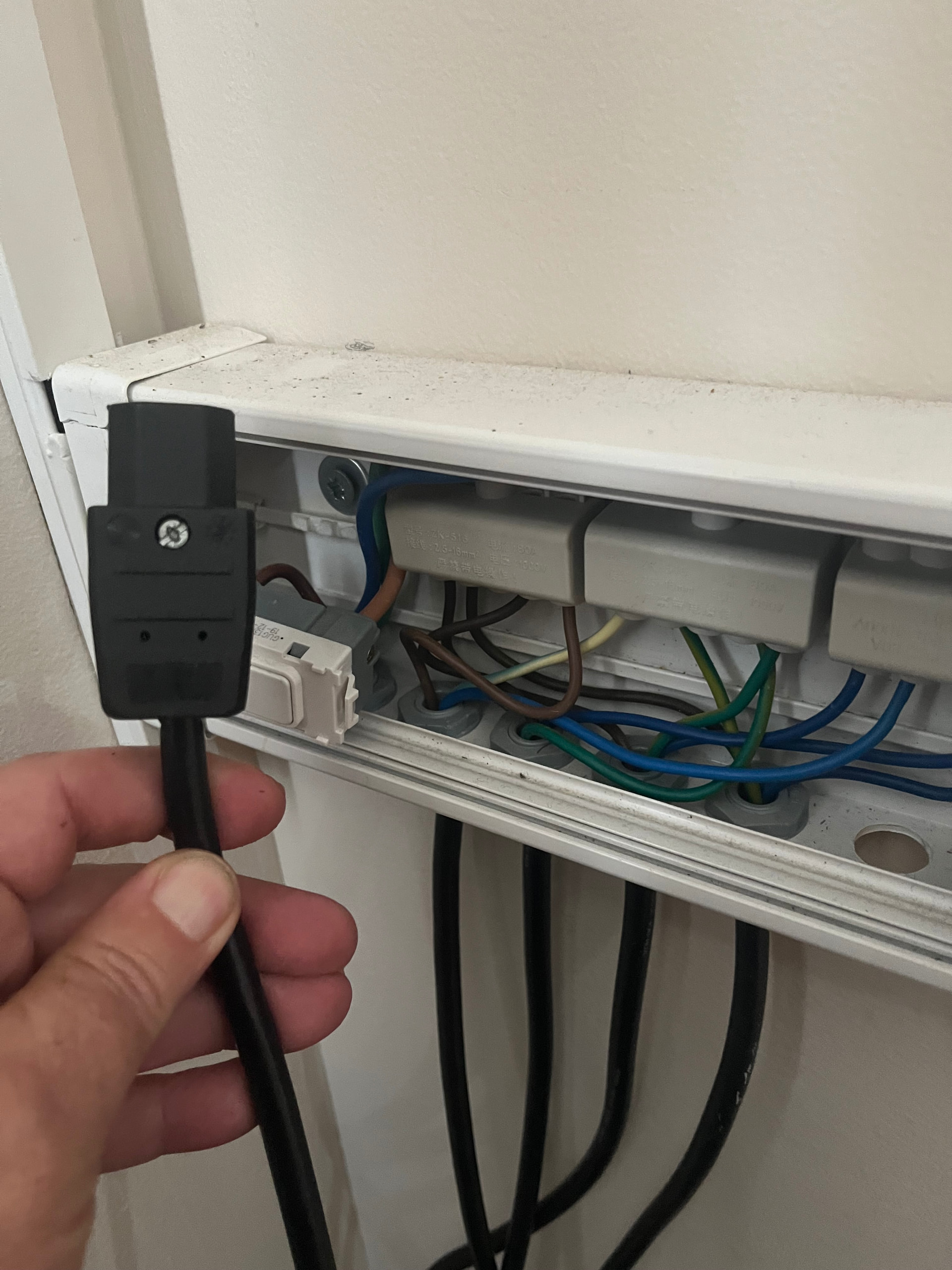

Just seen a picture of The blocks, He could make up a lead. I used 4mm high quality mains cable, and a good IEC plug,
I was not implying cut up power lines, Just showing I had hard wired,
I was suggesting a lead from the Henley block to the puritan,
Every item needs to have its leads individullay fused in the UK. Please show a photo of this complete installation with the items in the shot.
I never said they were Power-Lines or cutting off Power-Line plugs, I merely suggested that a Power-Line de-coupling would be lost.

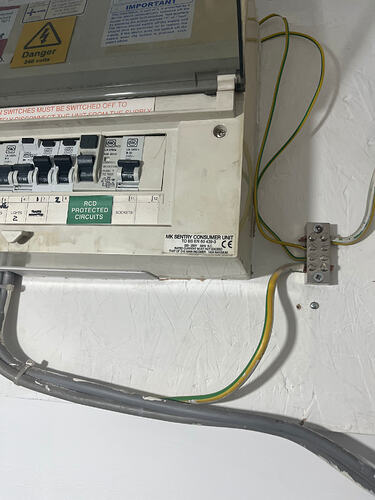

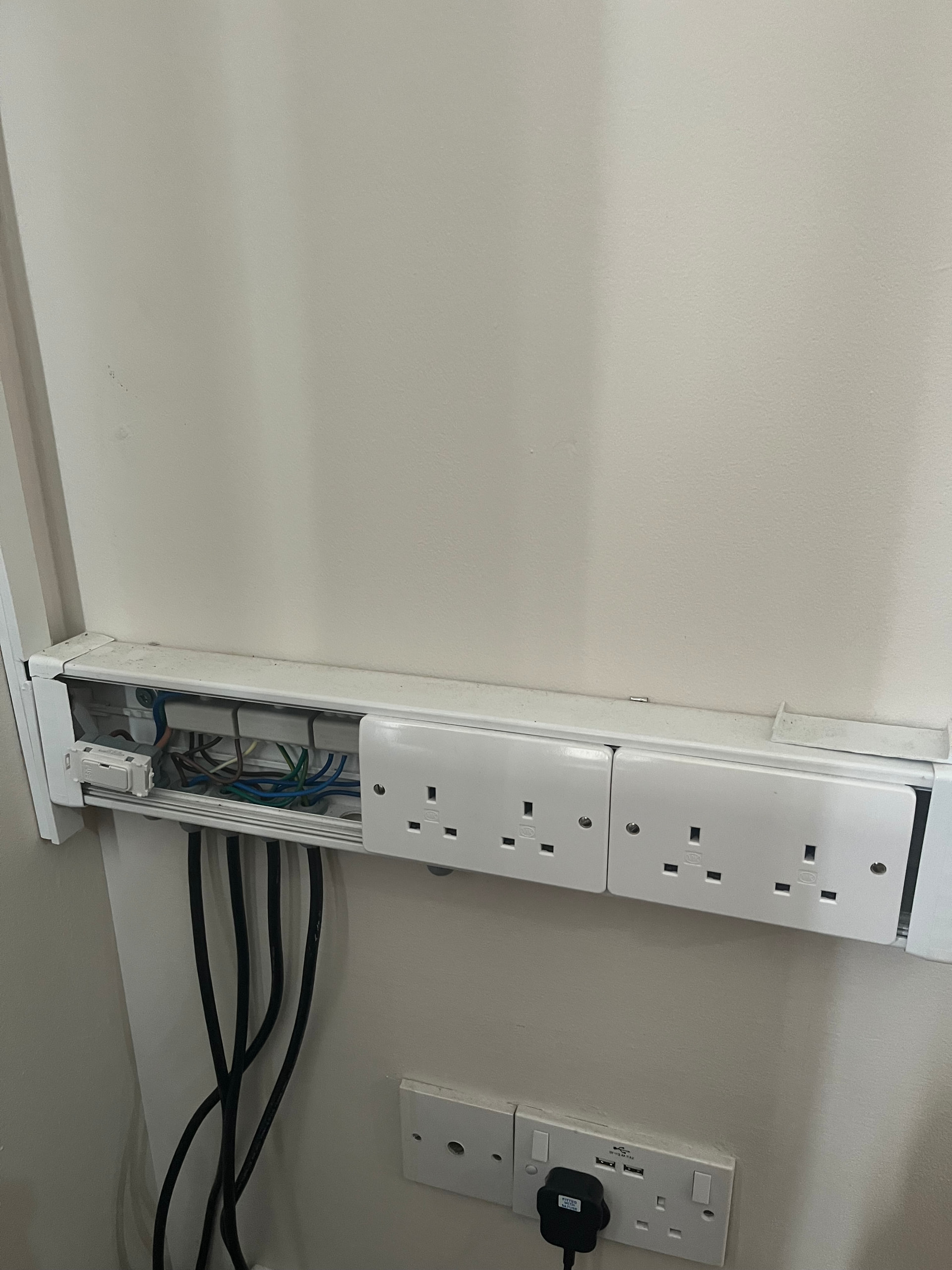

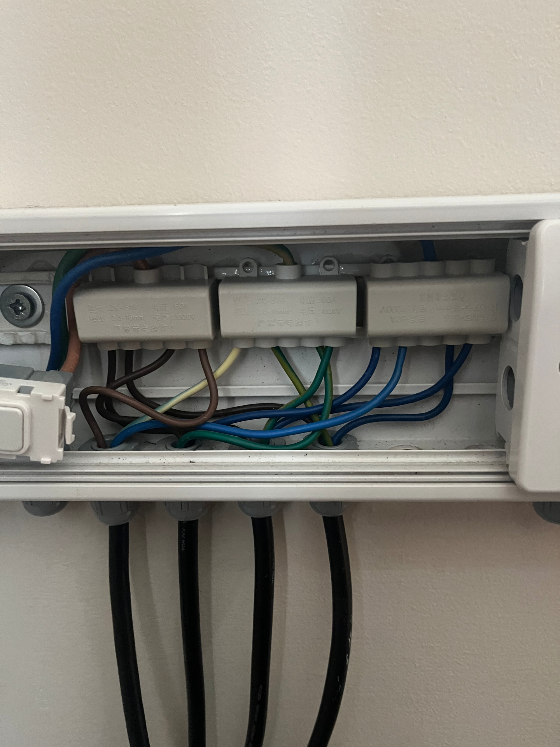

I have 2runs of 4mmT/E
1st run does the IEC leads with 13amp fuse
2nd run does the sockets
You’re missing the point. One of the purposes of a dedicated mains circuit for the HiFi is to isolate it from potential sources of electrical interference, and a router can certainly be that. Even switching power supplies on other HiFi equipment should be physically and electrically isolated from Naim boxes that use toroidal power supplies.

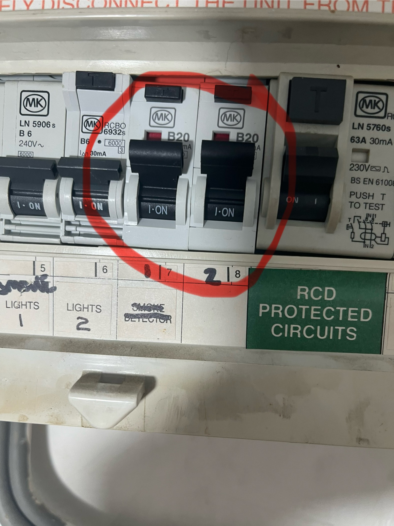

Very neat job. I currently have a 20 amp radial circuit off the main board with 4mm cable, 2 unswitched mk sockets. So yours is a stage further.
Have you considered a dedicated 10mm radial off the incoming mains as opposed to the existing consumer unit or are you happy with what you have.

I used the main CU and separated the earth, Main reason was to stop pops and clicks from fridge, thermostat and freezer, I now have none of that,:wink:
If that did not work I would have put in a separate CU.

Yeah, when I did my radial circuit sorted out problems with my AV gear from fridge. It is a very good solution. You have gone a step further than what I did initially.
Guys on hear and Naim say ultimate solution is dedicated mains.
Will wait until my electrician comes over to have a look which wiĺl be in next couple of weeks. I won’t push him as working outside isn’t great at the moment!
