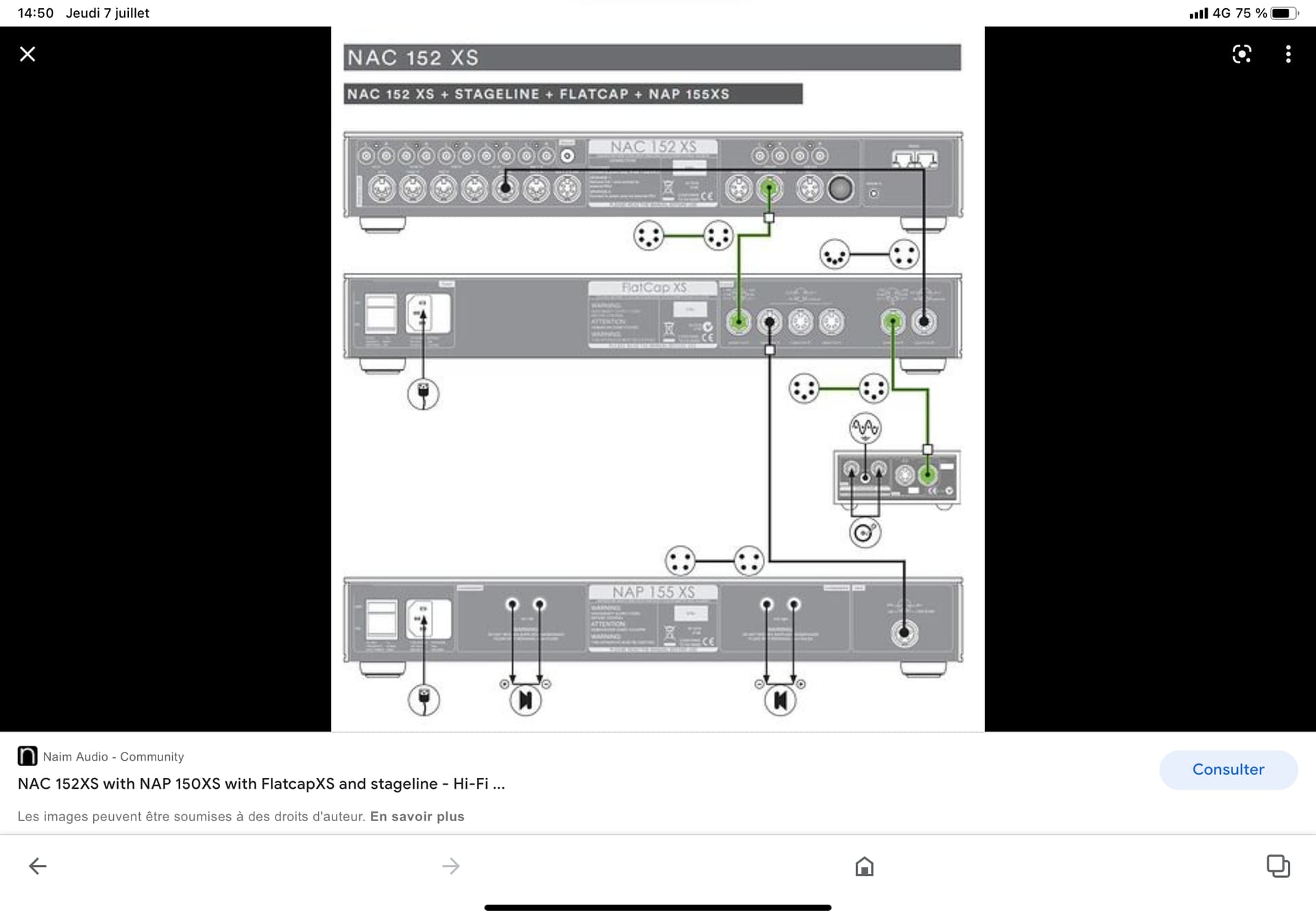

I have a Nac 122x connected to a Flatcap2x and I wonder what is the best way to connect a Stageline S phonostage (first version, with only one output)?
It is directly to the 122x using the Aux2 & Pwr input?
Or is to the Flatcap’s Power out B?
Is there in differences between the earlier Stageline and the latest, besides the dual output? They have equal performance?
Thanks in advance :slight_smile:
Should help
Yes, thanks a lot :slight_smile:
You try it both ways and if you prefer direct you regret buying the 4/5 interconnect but it may come in handy if the upgrade bug takes you far enough.
The interconnect is the same (light grey color) used by the CD5x?
That’s a 5/5 interconnect but running an old style stageline from a flat cap the signal travels in the Snaic to the flatcap 2x and to take the signal from the flatcap to the pre it’s a 4/5 interconnect. The pin layouts are in the diagram above. A CD5x doesn’t send its signal via the ps.
