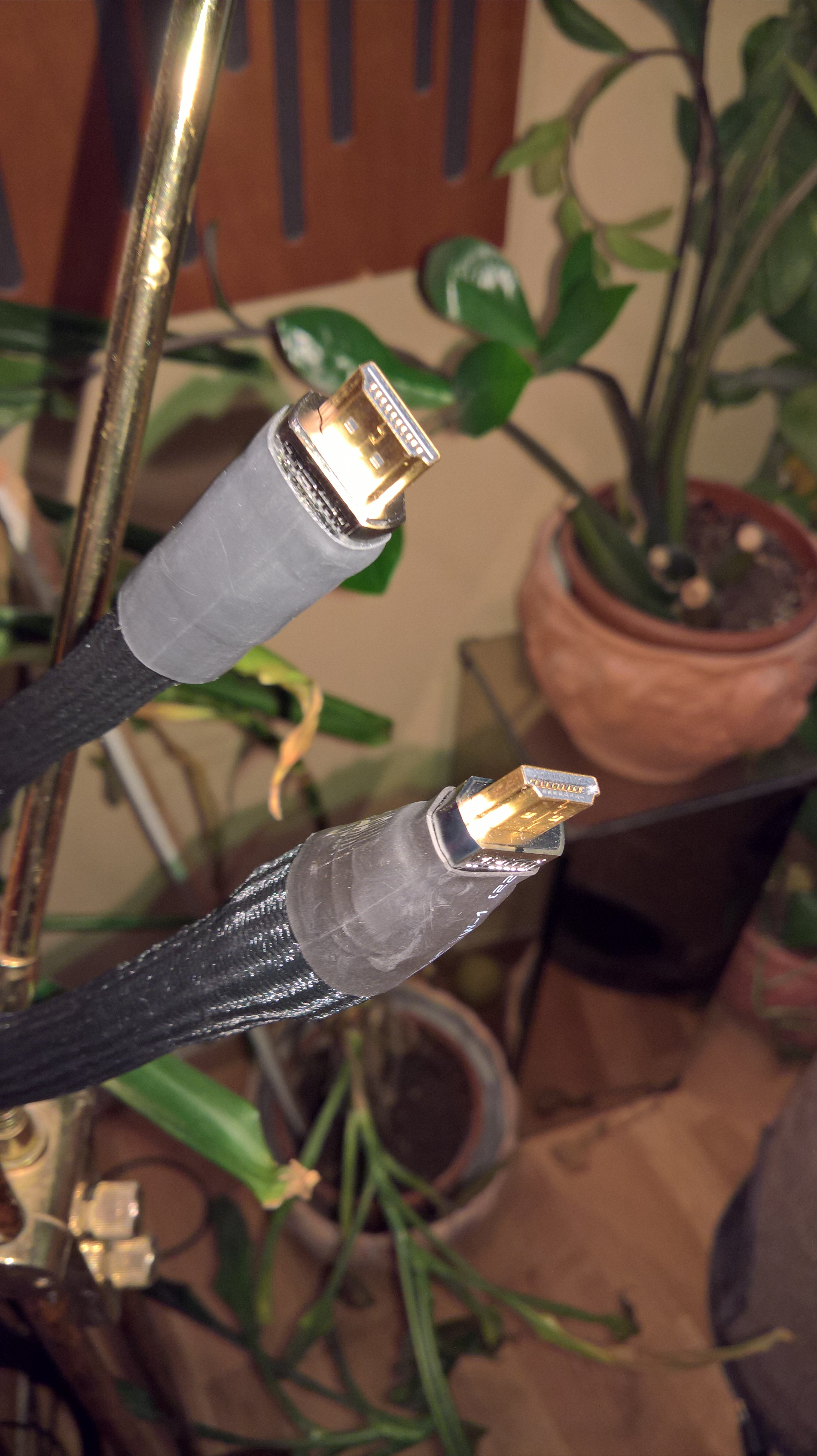

A simple question.
Is there anyone here,.who has experienced that the picture getting better on your TV with better HDMI-cables,.or the sound.?
/Peder🌼
