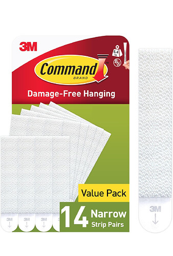

I ordered some panels, each has 1 kg weight. They have a self adhesive back. But I don’t want to stick them to the wall, which has a wallpaper, because if I don’t like the effects, it will degrade the wall paper.
So my question : do you think I can stick them with blue tack?
1 kg panel will adhere to the wall with blue tack ?
Maybe use silicone and prop them until they set. Or contact adhesive spray form. Check with manufacturer on fixing methods.
I don’t think BluTak would work. We use 3M Command Strips on ours, which is easy to remove leaving no residue.
