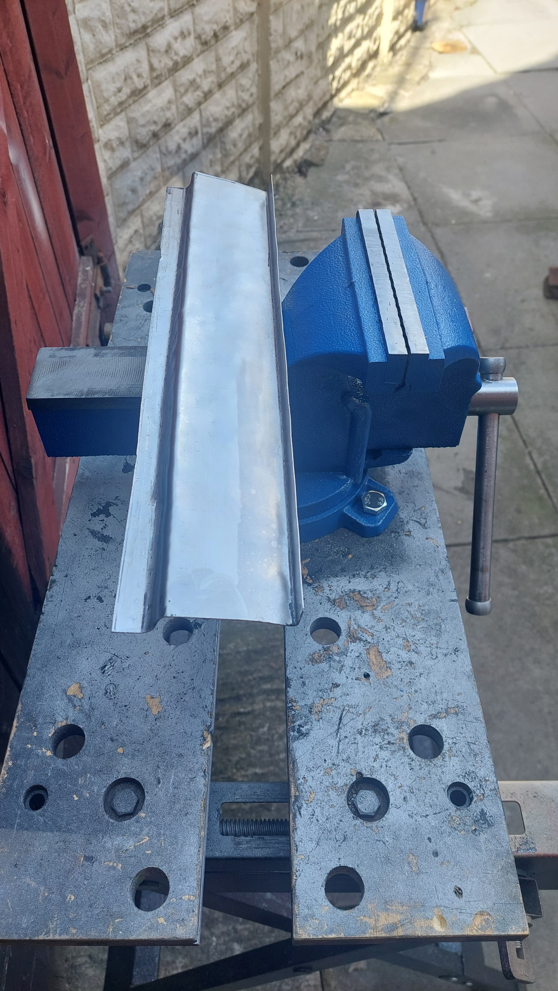

This was only 1mm but I used my little vice to make it.
